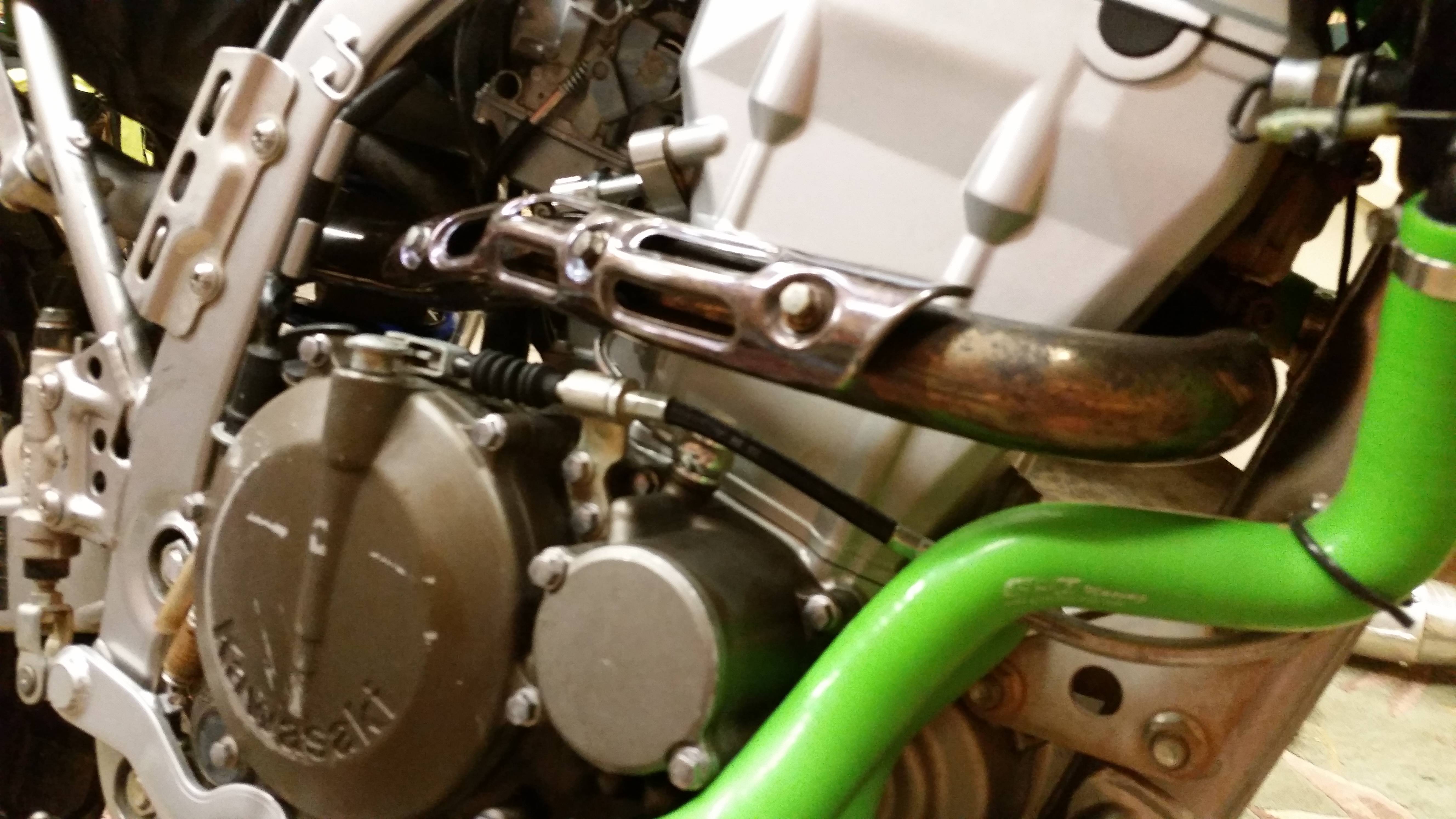

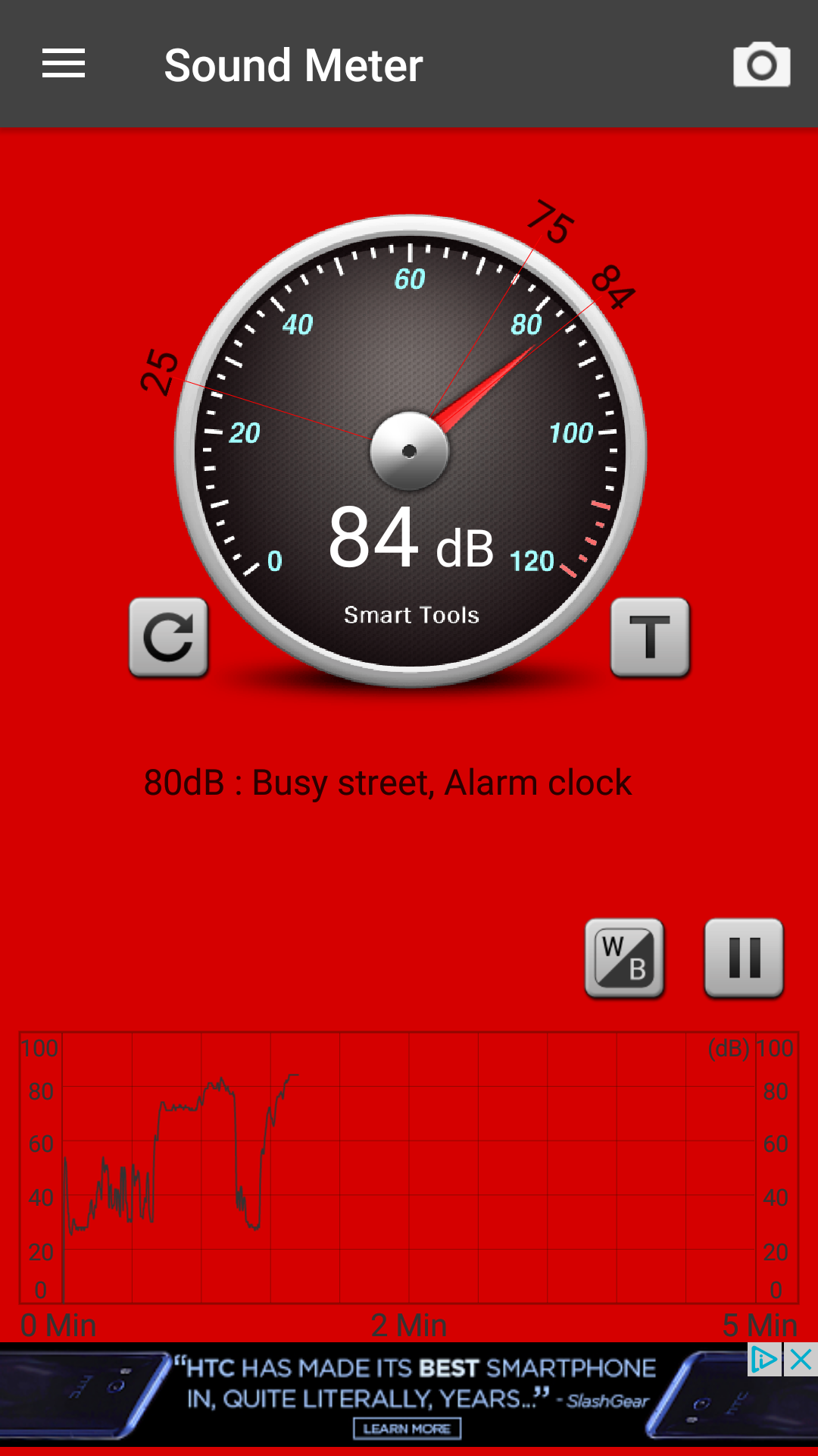

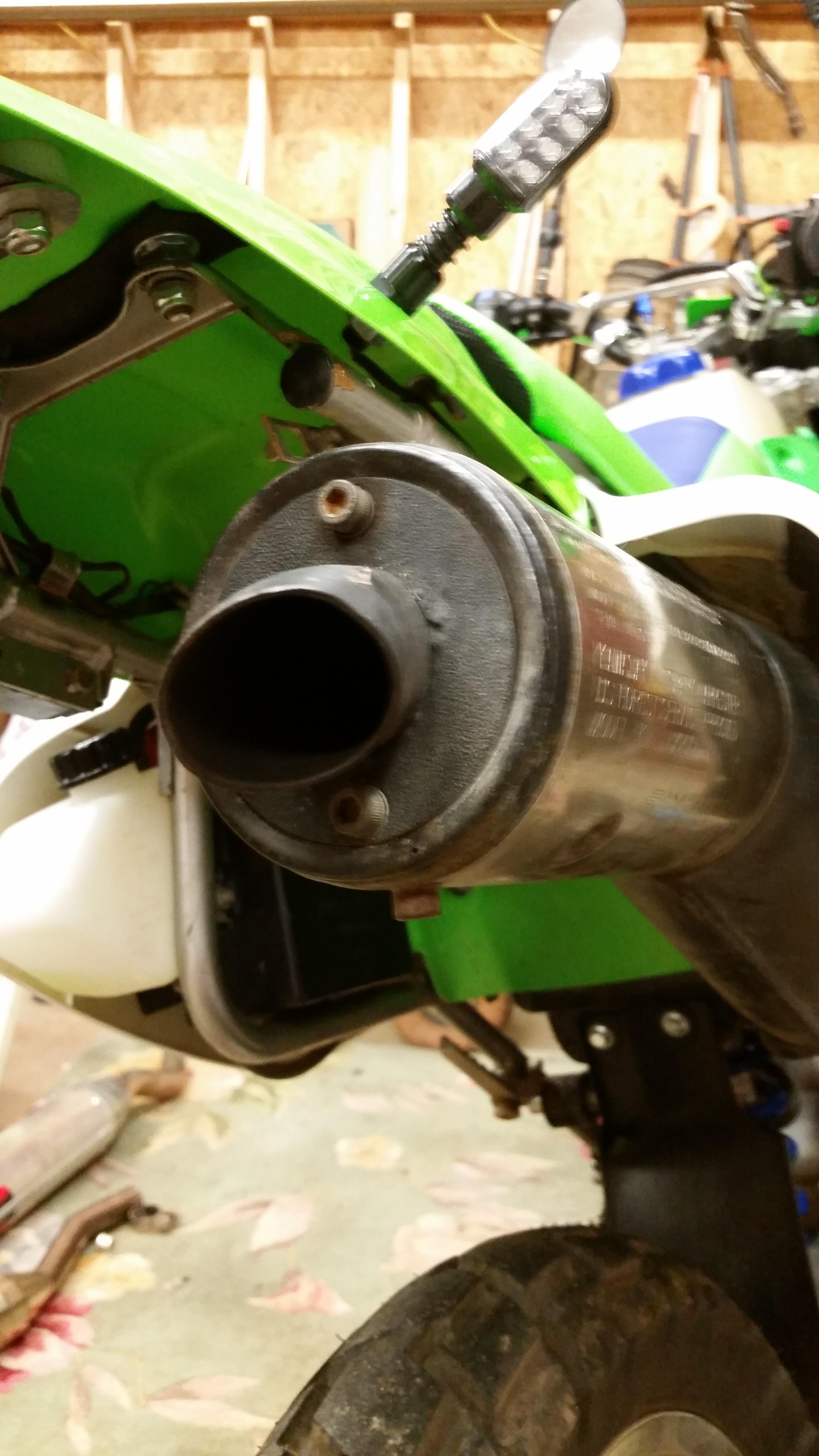

Got the KLX300R exhaust system hooked up tonight. This one has a modified end cap much larger than stock. The rest of the insides are in tact from what I can see.
The 300 muffler has a different tone quality to it, but it unfortunately (for me) is just as loud as the Q4/megabomb/quiet insert combo I had before.... at least at 4500 rpm.

Yep, that endcap foiled your plans..You need the stock peashooter end cap..

At least this one looks a little easier to modify. Going to see if I can thread something into the inside opening of the cap to reduce the diameter a little.
84 DB's ? that sounds pretty quiet to me , Best I get for my q4, quiet tip, fresh repack 95 DB's,newer PC 4 97 Db's.I think I'm going back to stock exhaust ,I drilled out the butt of the stock can 2" , and hammered and chiseled out the p shooter and chamber and will put a screen and tip on it and try that for a while , Will probably need to re jet , I took it out for a run and naturally it doesn't have the juice with the full exhaust , but loving the quiet ..
