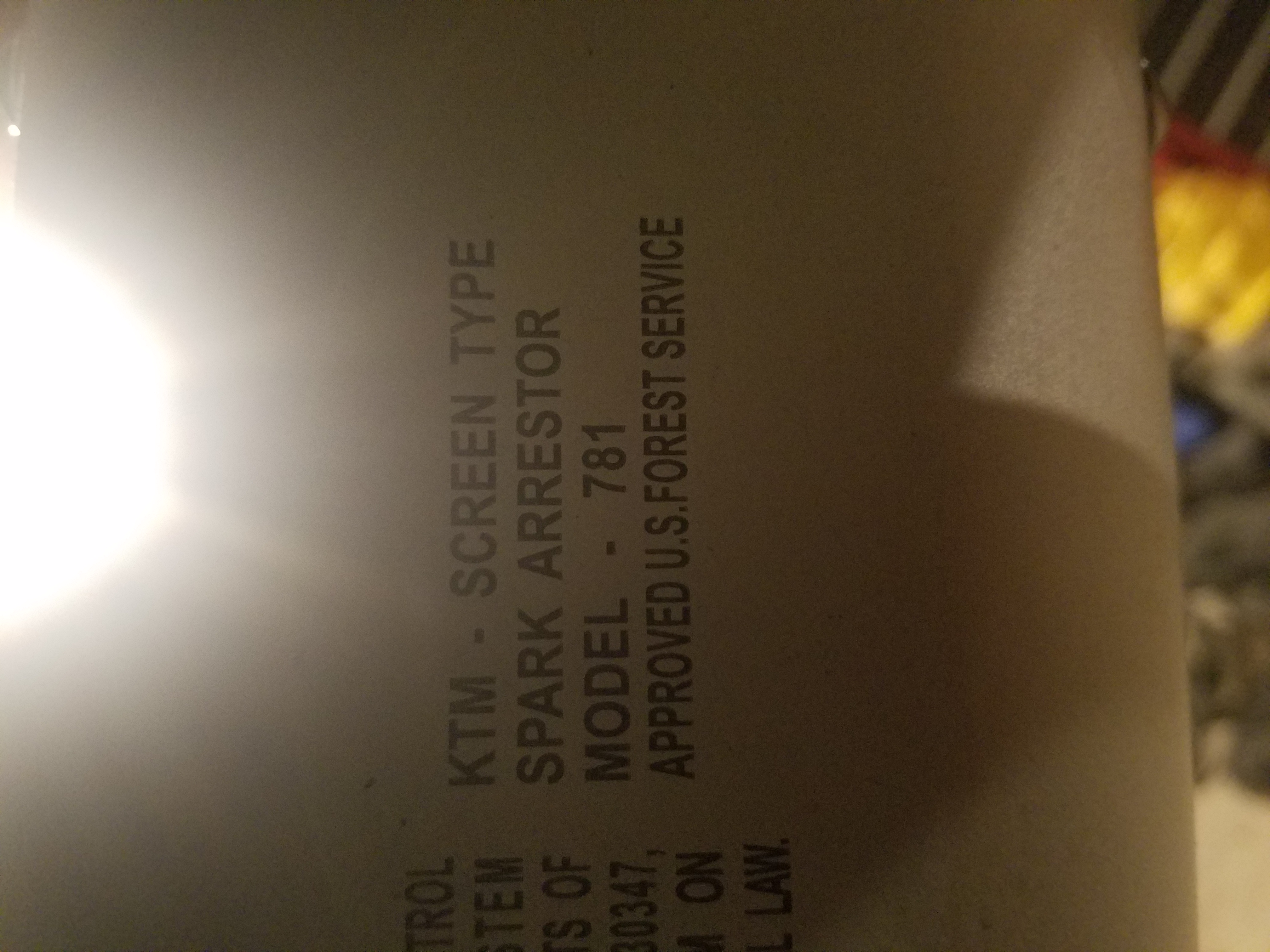

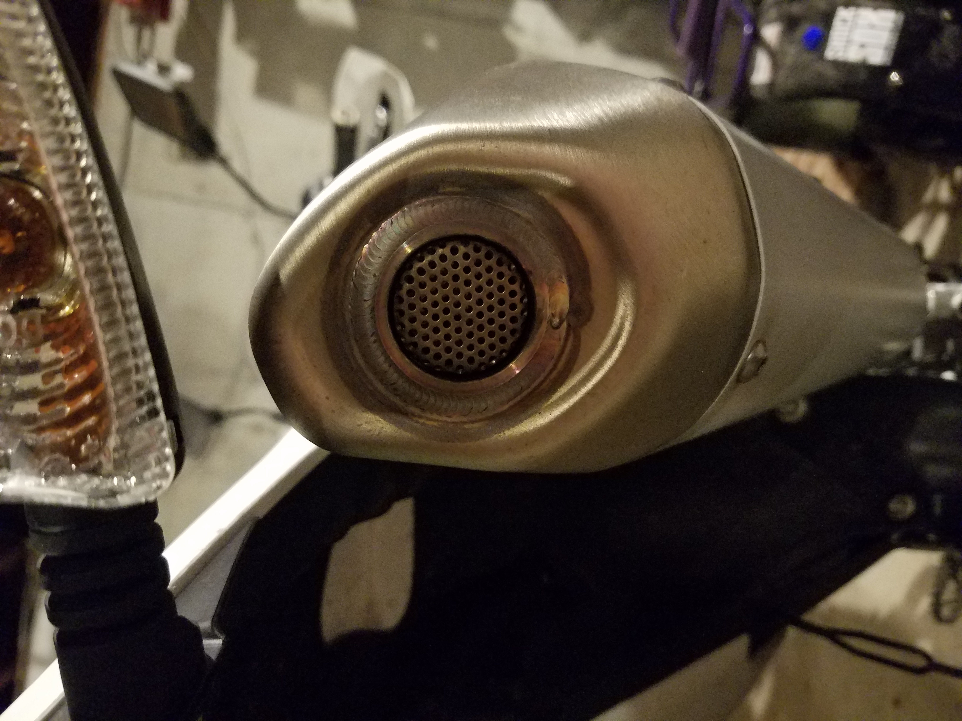

s10gto what is your FE350S muffler part number? (should be stamped in black on near the back)
I will check as soon as I get home in a couple hours.
Here is the screen I am referring too. It caps the end and can not be removed without cutting.

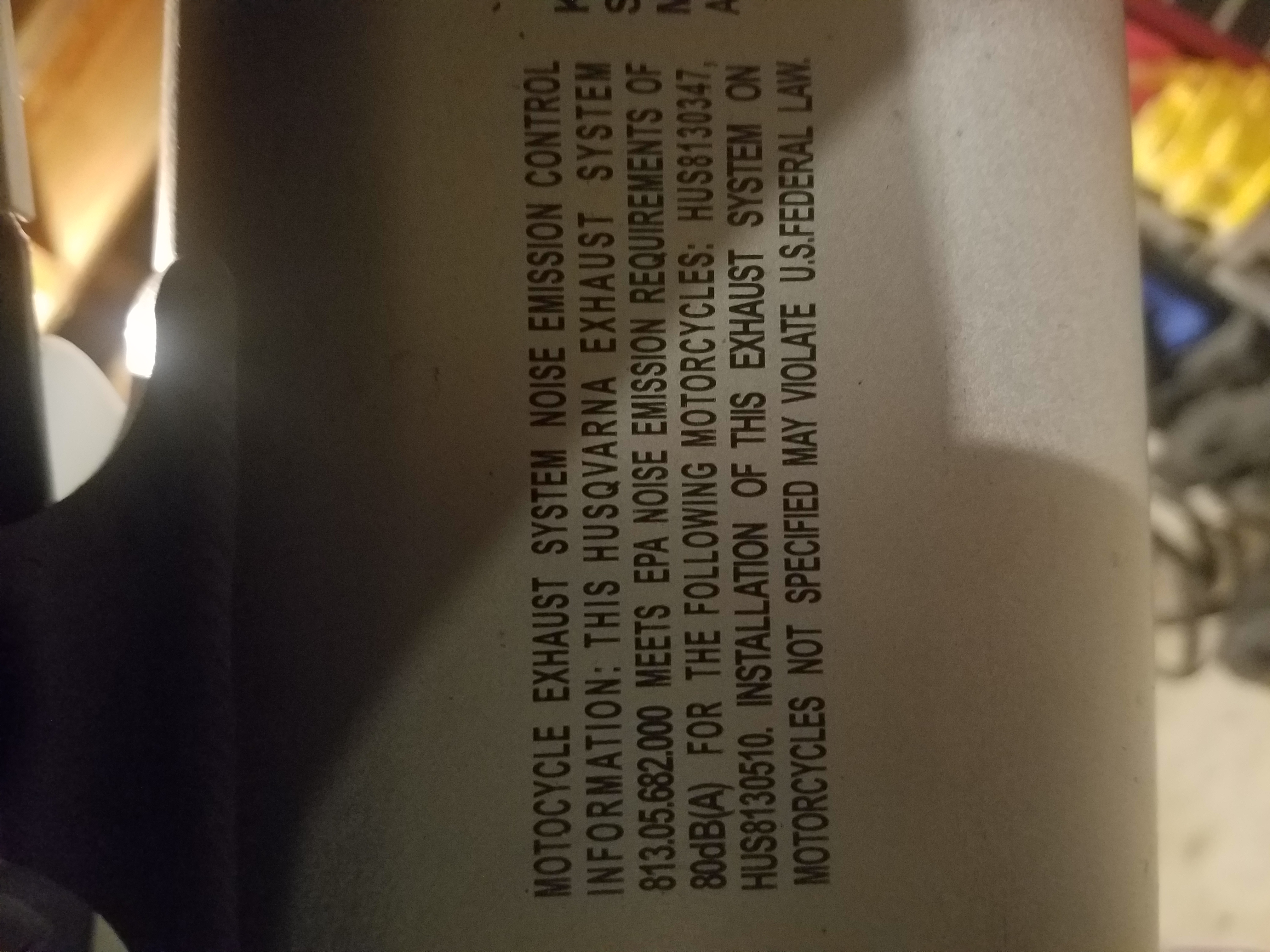

Here ya go. 813.05.682.000 model 781
Attached Thumbnails Stock exhaust with FMF megabomb?-20170718_201453.jpg   Stock exhaust with FMF megabomb?-20170718_201511.jpg
Old Jul 19, 2017 | 02:23 AM
  #83
queen of spades's Avatar
Joined: Apr 2016
Posts: 389
Much obliged. Will be in radio silence for a few weeks but will come back to the thread as I move foward.

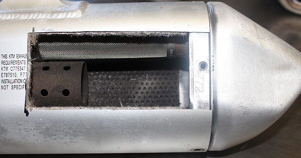

Here's another view of the inside of a modern KTM EXC style muffler:
Instead of allowing exhaust to flow straight through and out the end cap, KTM dumps the exhaust into an open chamber where the sound waves bounce around and help cancel each other out. Exhaust then finds its way out the end cap which is strategically placed completely out of line with the inlet tube.

More info on the KTM mufflers. Apparenlty, KTM only packs half of their muffler cans with fiberglass. The other half is shown in the cutaway above.
Here's a thread on ADVrider with a few more pics and info: KTM 450EXC Muffler Rebuild | Adventure Rider
Now wondering if I shouldn't consider adapting a KTM EXC two stroke silencer, the kind that has the angle to it. That would provide a LOT more silenced, perforated exhaust.

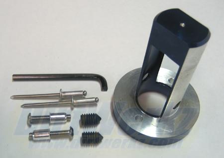

I found one more possible option:
https://www.dirtwerkz.com/Pages/prod...t/dB_Dawg.html
It's a DB Dawg listed for the 06 YZ450f, part number 8010B. The page says it will fit in a 1 1/8" opening, which happens to be the size of the Q4 quiet core insert. This should shrink the opening down a little more.

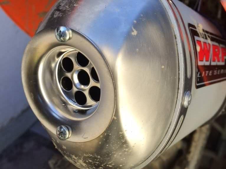

This also looks interesting but I can't find a vendor for it.
