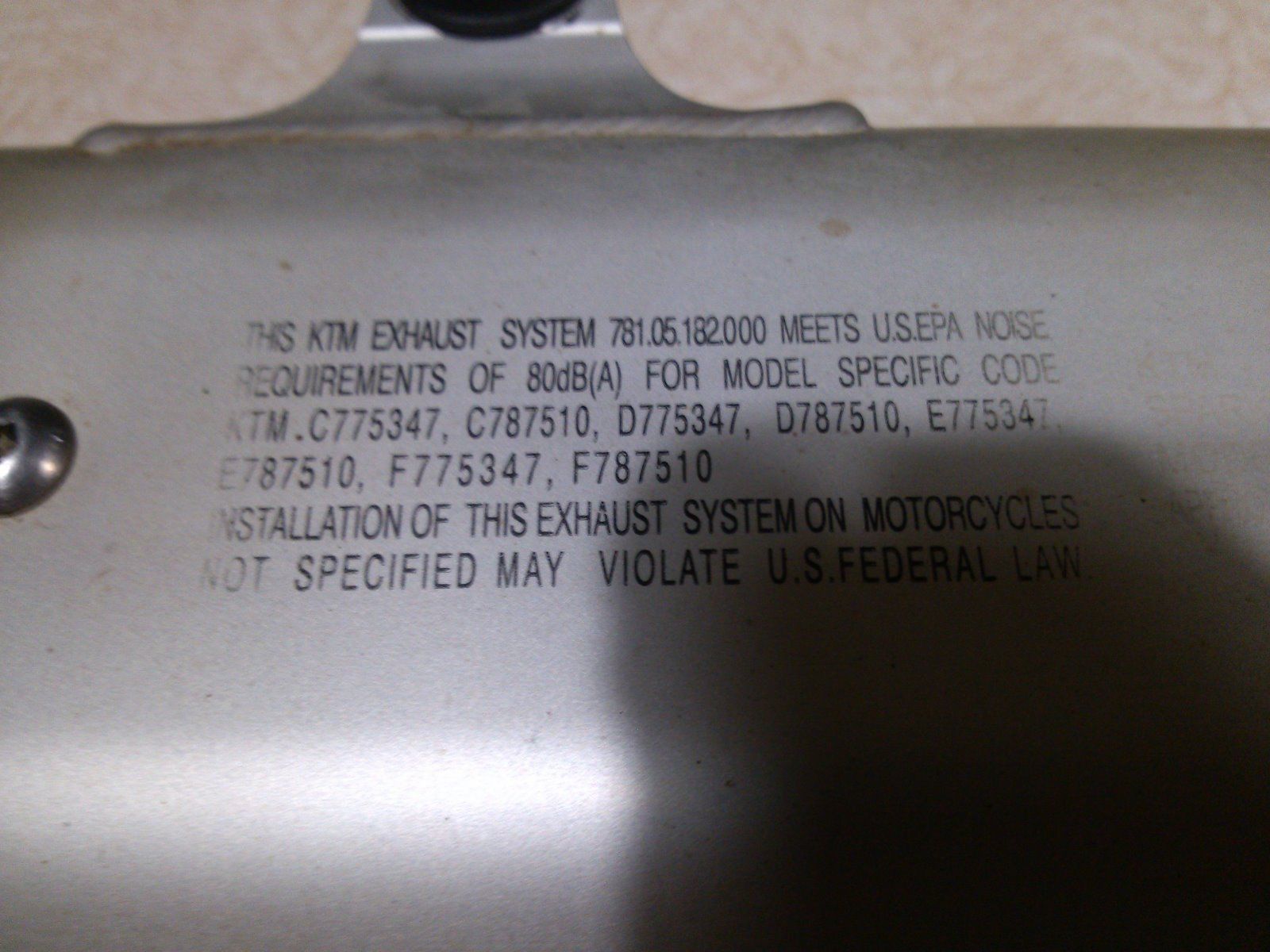

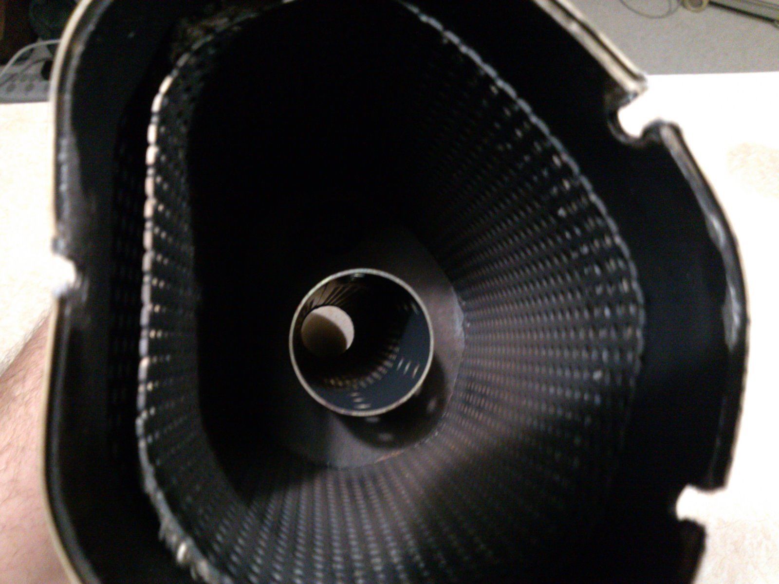

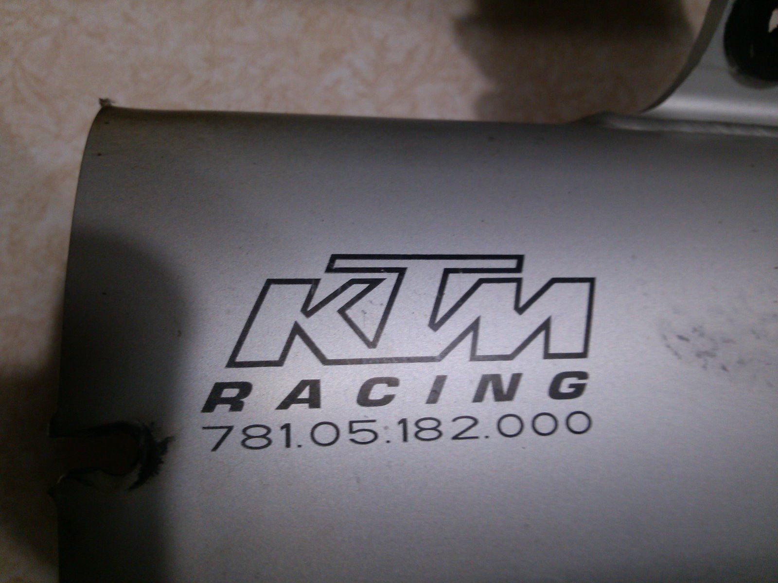

Here is what the inside of a EXC muffler (p/n 78105182000) looks like.
78105182000 muffler for KTM 350 EXC - what the innards look like - Album on Imgur
