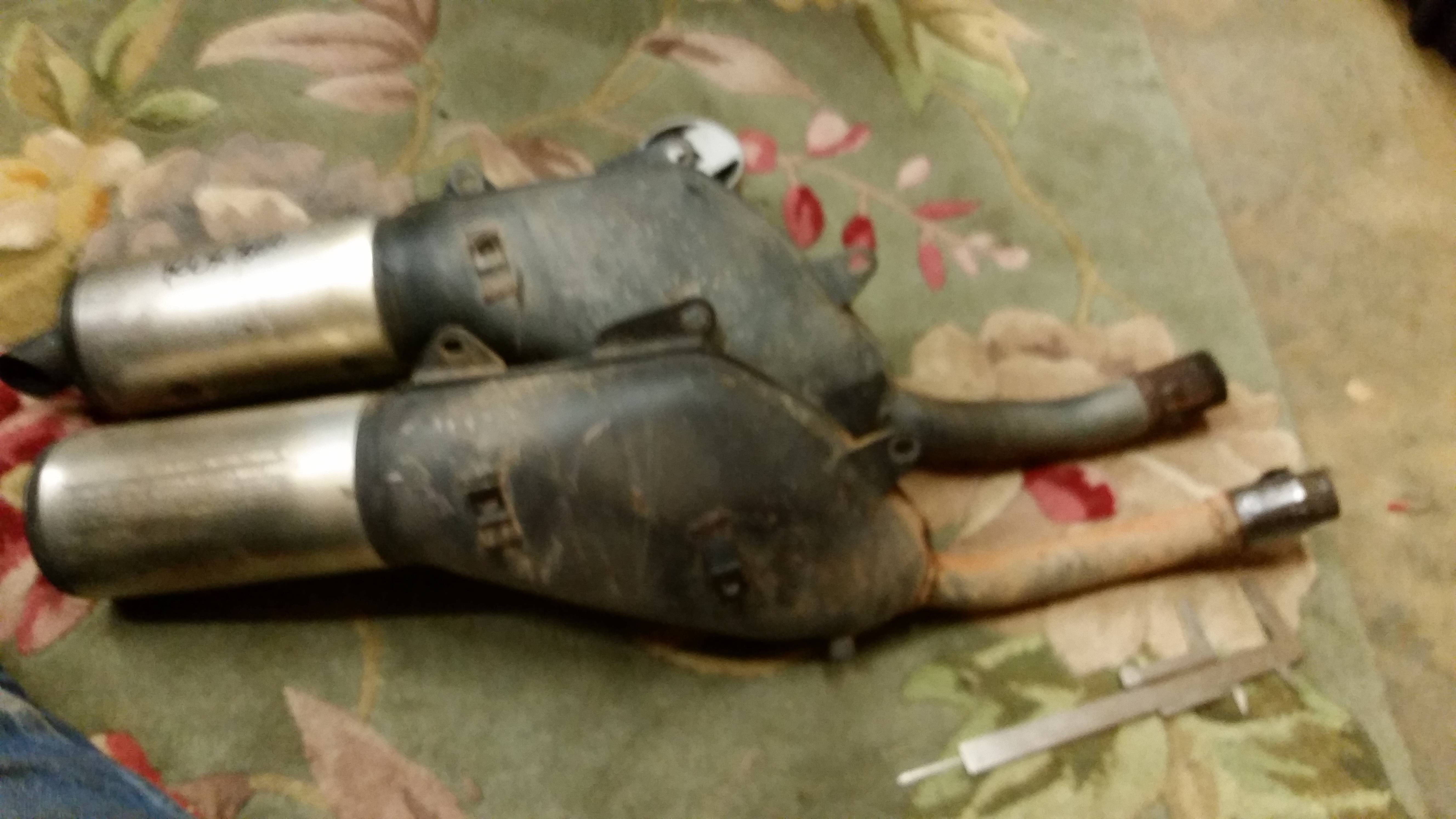

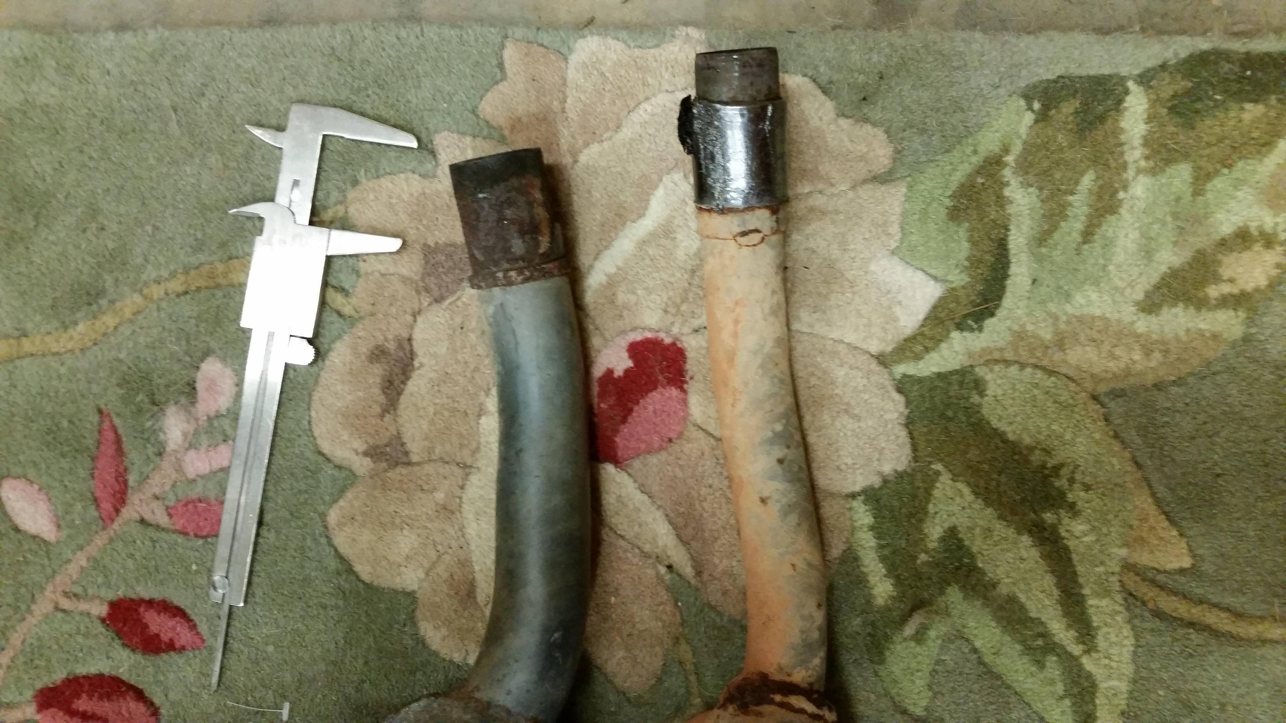

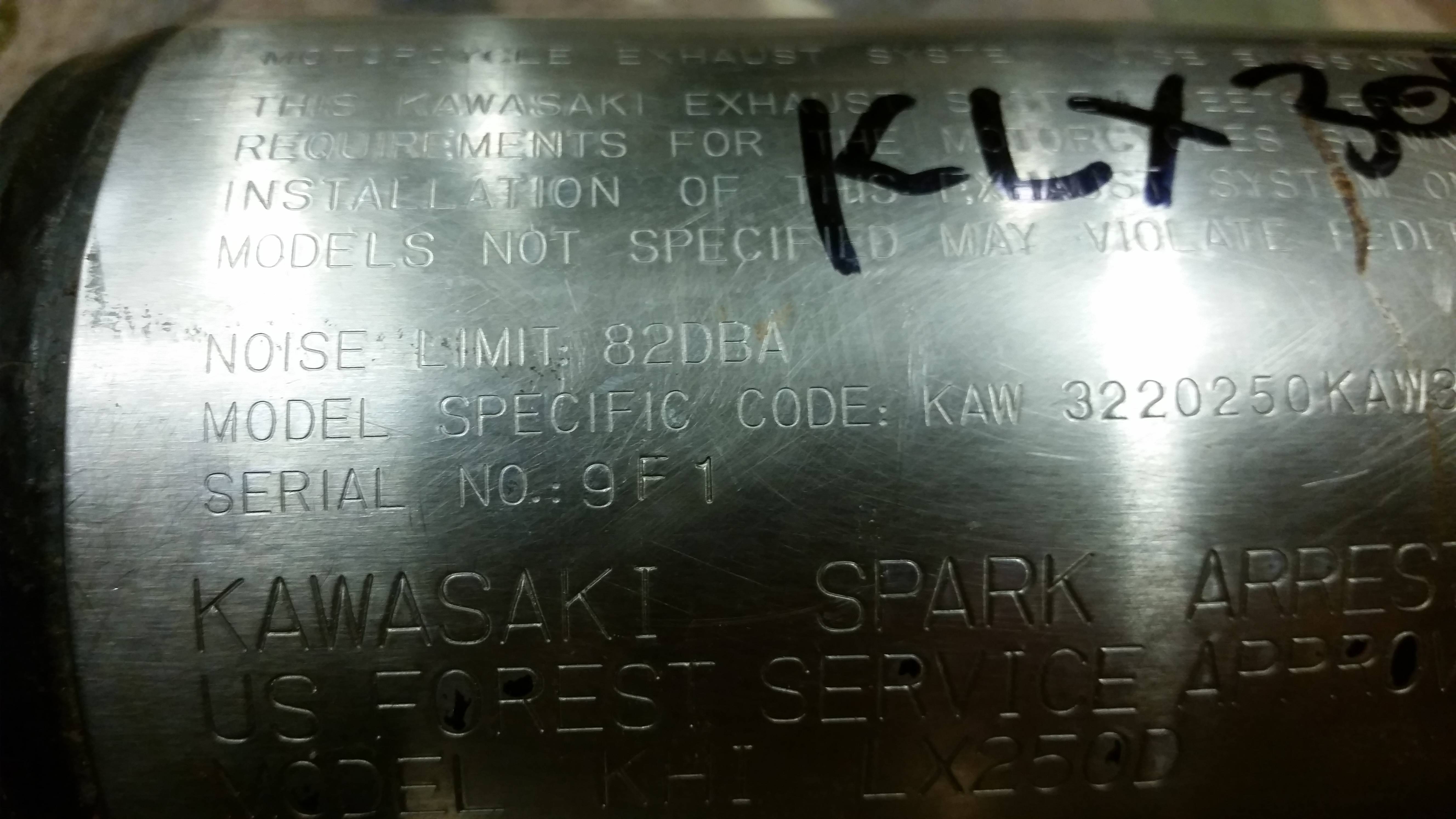

Here are comparison photos of the OEM KLX250-S muffler next to an OEM KLX300R muffler. (apologies for first pic blurriness, I need a better camera app).
Muffler inlet stinger
KLX250S: 1 1/4".
KLX300R: 1 1/2".
The KLX250S muffler appears to be 1 (one) inch shorter than the KLX300R muffler.

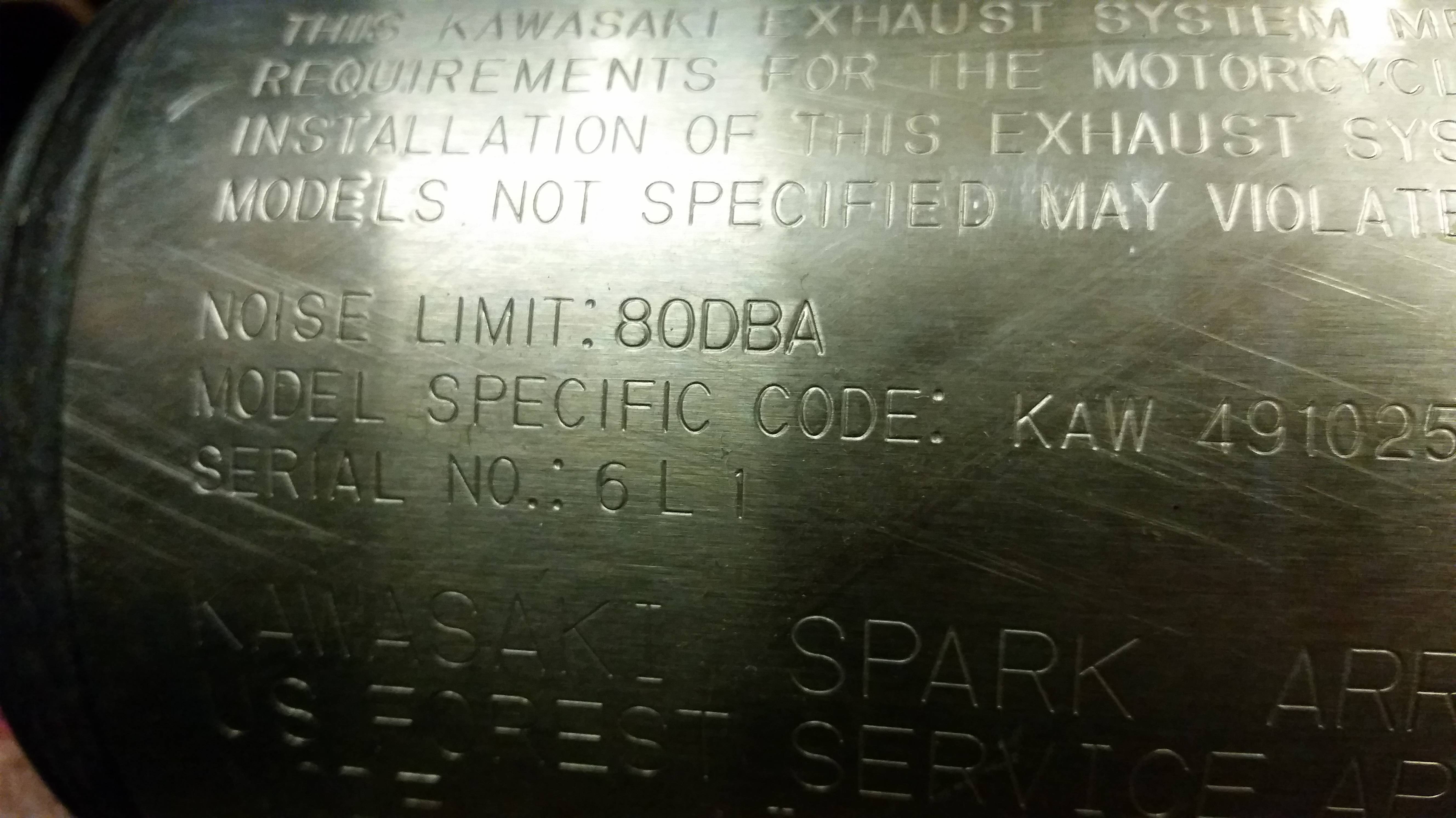

Both mufflers are spark arrested. Both have "LX250S" stamped on the manufacturers plate, though the KLX300R has a listed DBA of 82. The KLX250S has a listed DBA of 80.
Going riding today in mountains where I can be a little louder so the FMF stays on the bike for now. Will test fitment next week as I am able.

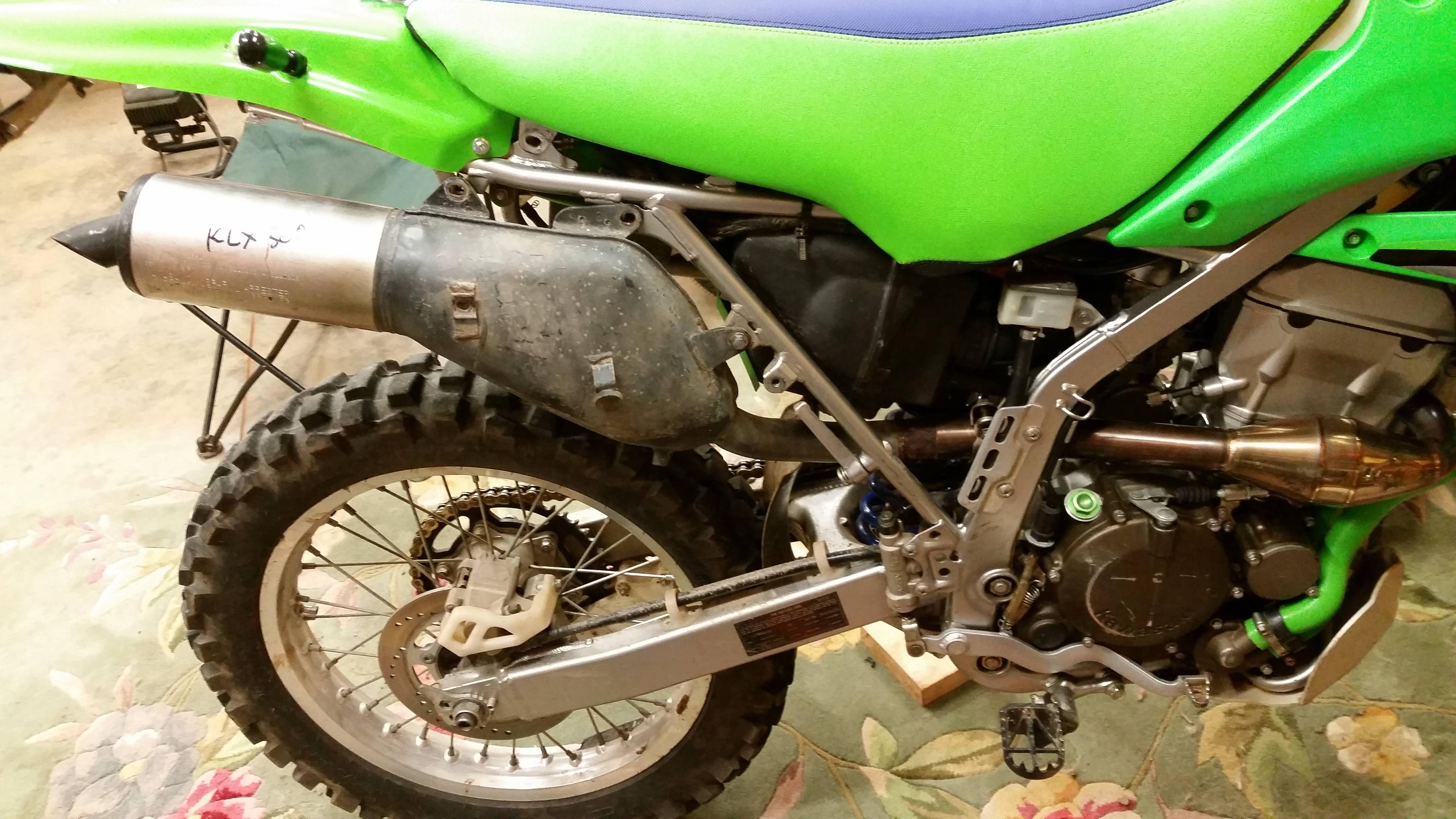

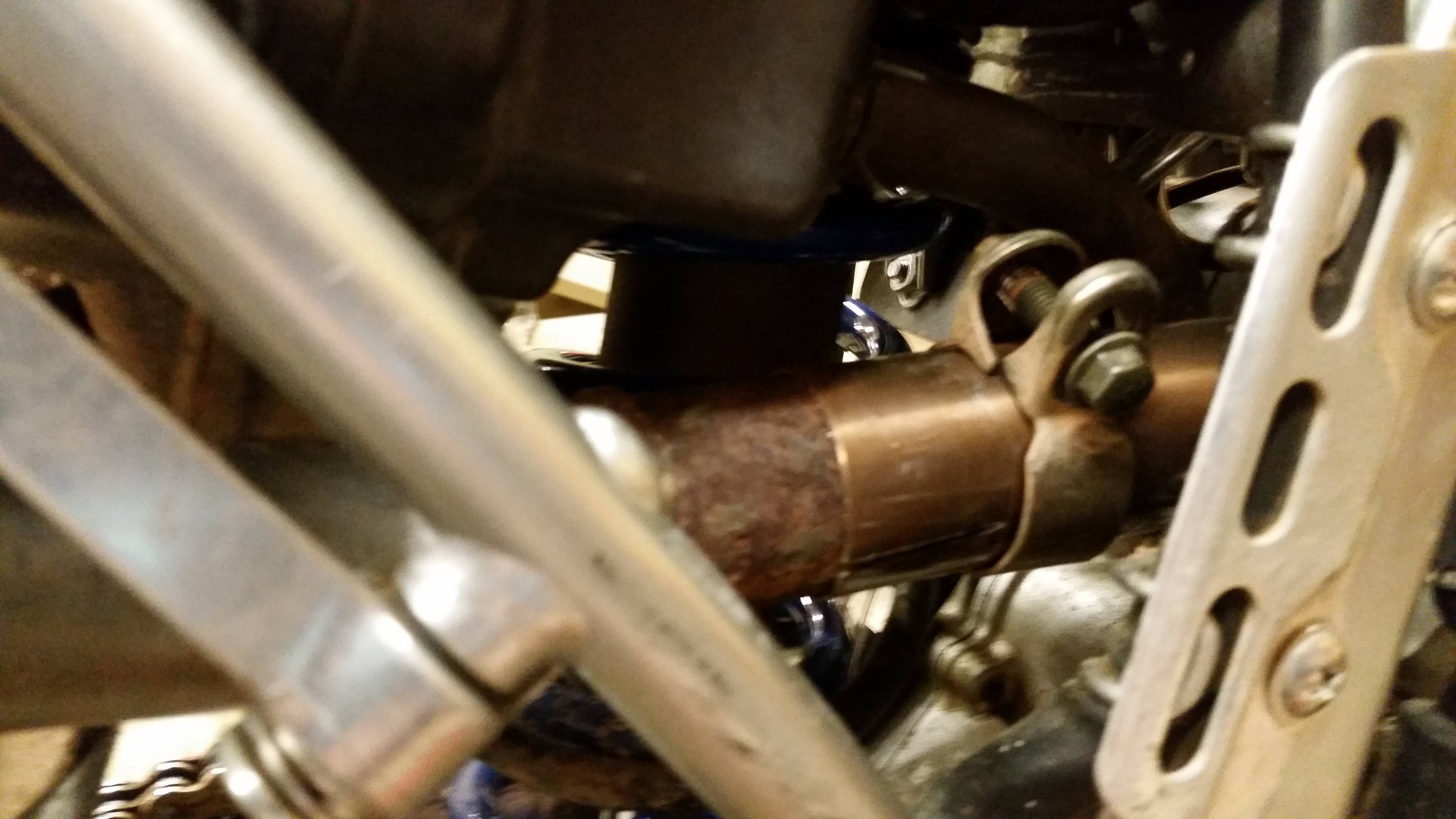

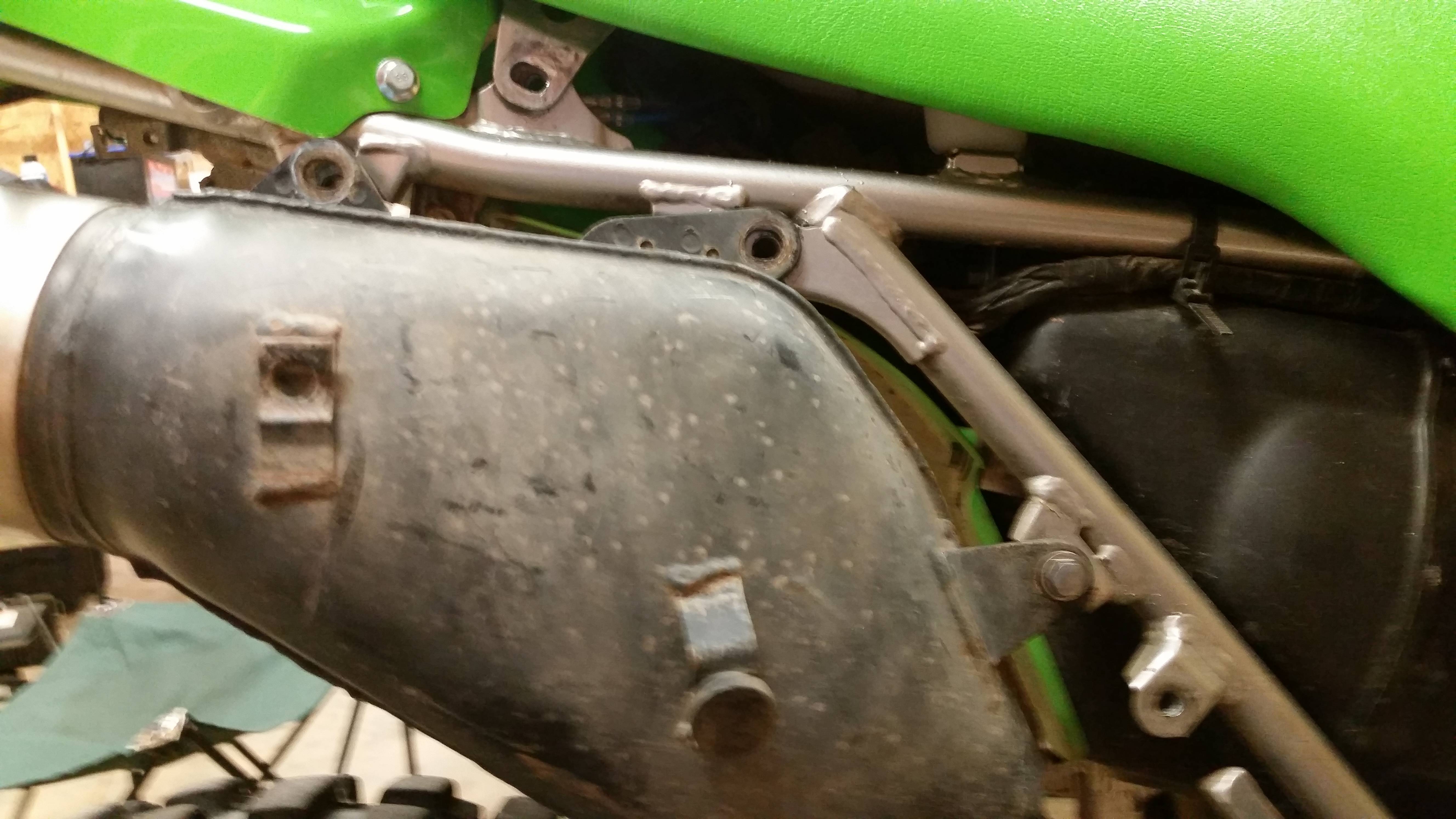

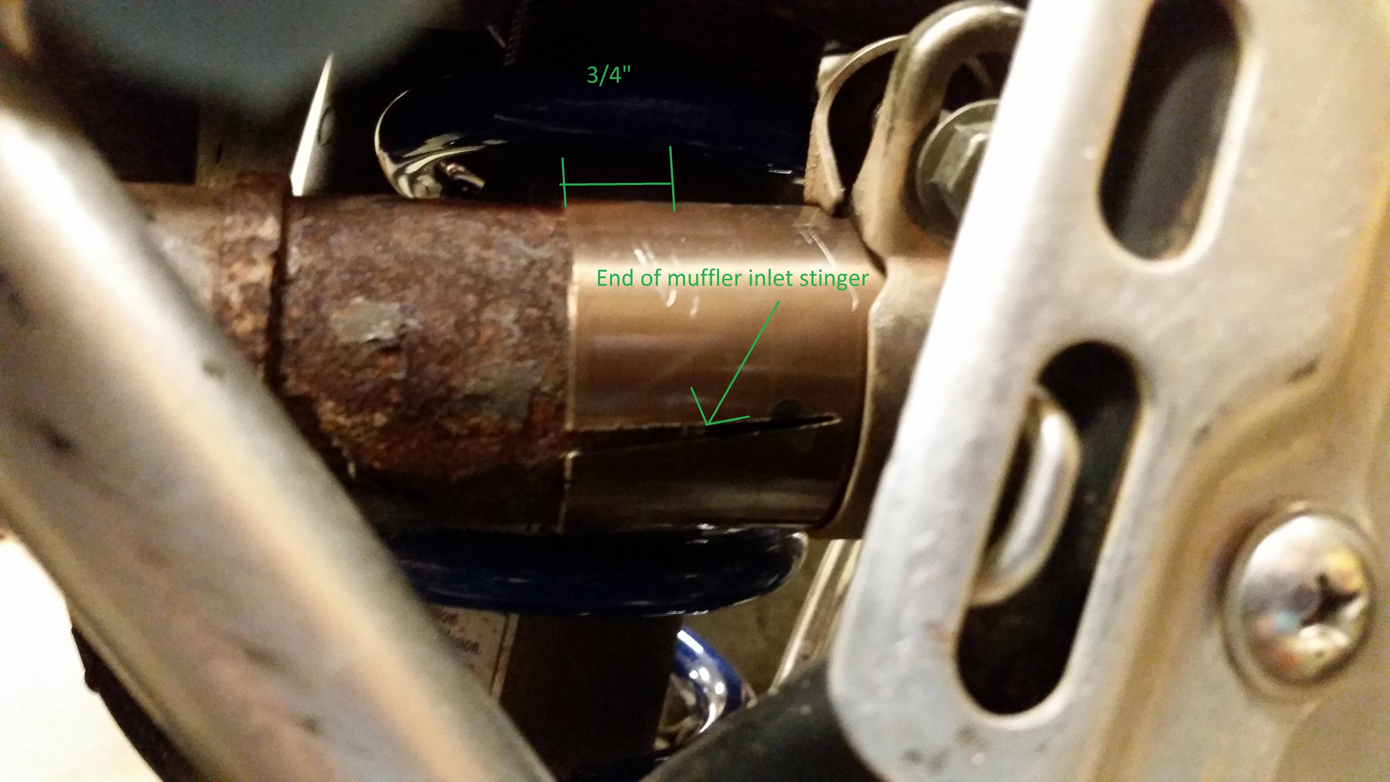

Here is the OEM KLX300R exhaust on a KLX250-S with FMF Megabomb. It does not fit properly when everything is bolted up.
The FMF Q4 slides way up in the Megabomb header, past the cut slots you see in the pic below. OEM KLX300R muffler only goes in the Megabomb header about 3/4".

Also got my used KLX300R header in today. It's 1 1/4" in diameter, then steps up at the stinger to meet the larger KLX300R inlet.
So for now I'll plan on swapping entire exhaust system when I want to ride stealth.

No pipe stretcher - the KLX300R does not fit far enough into the Megabomb. There is only 3/4" of contact and that is being generous.. maybe only 1/2". See pic above. Even if the Megabomb were longer, using a pipe stretcher on it would mean I can't use the Q4 anymore since it will no longer seal properly.
I have a working solution now, so I am not going to damage my $$$ Megabomb by stretching.
The OEM muffler (and I guess OEM header per photos above) are plenty quiet enough for stealthy riding. I'll keep the FMF & Megabomb for times where noise is less of an issue.
