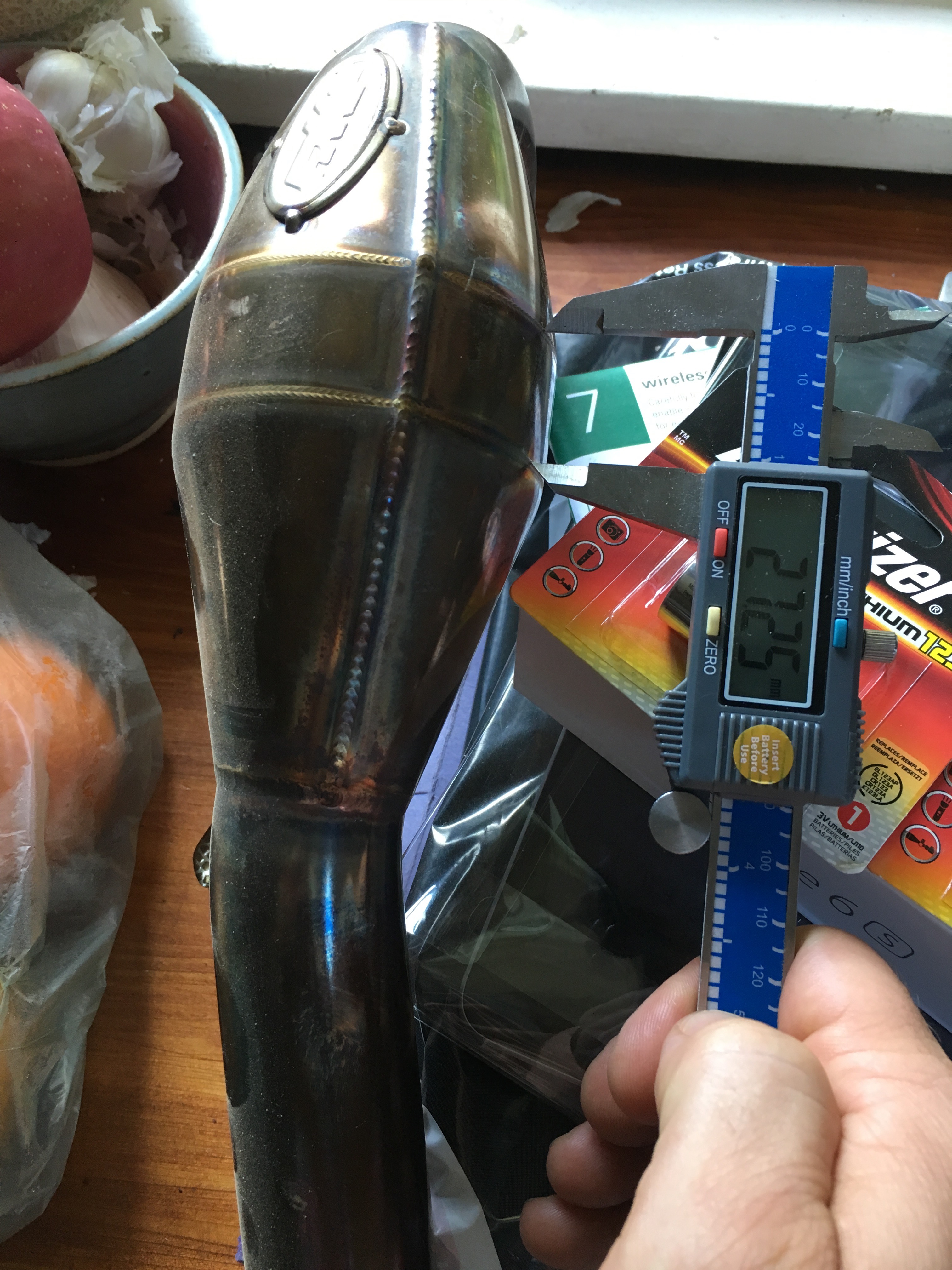

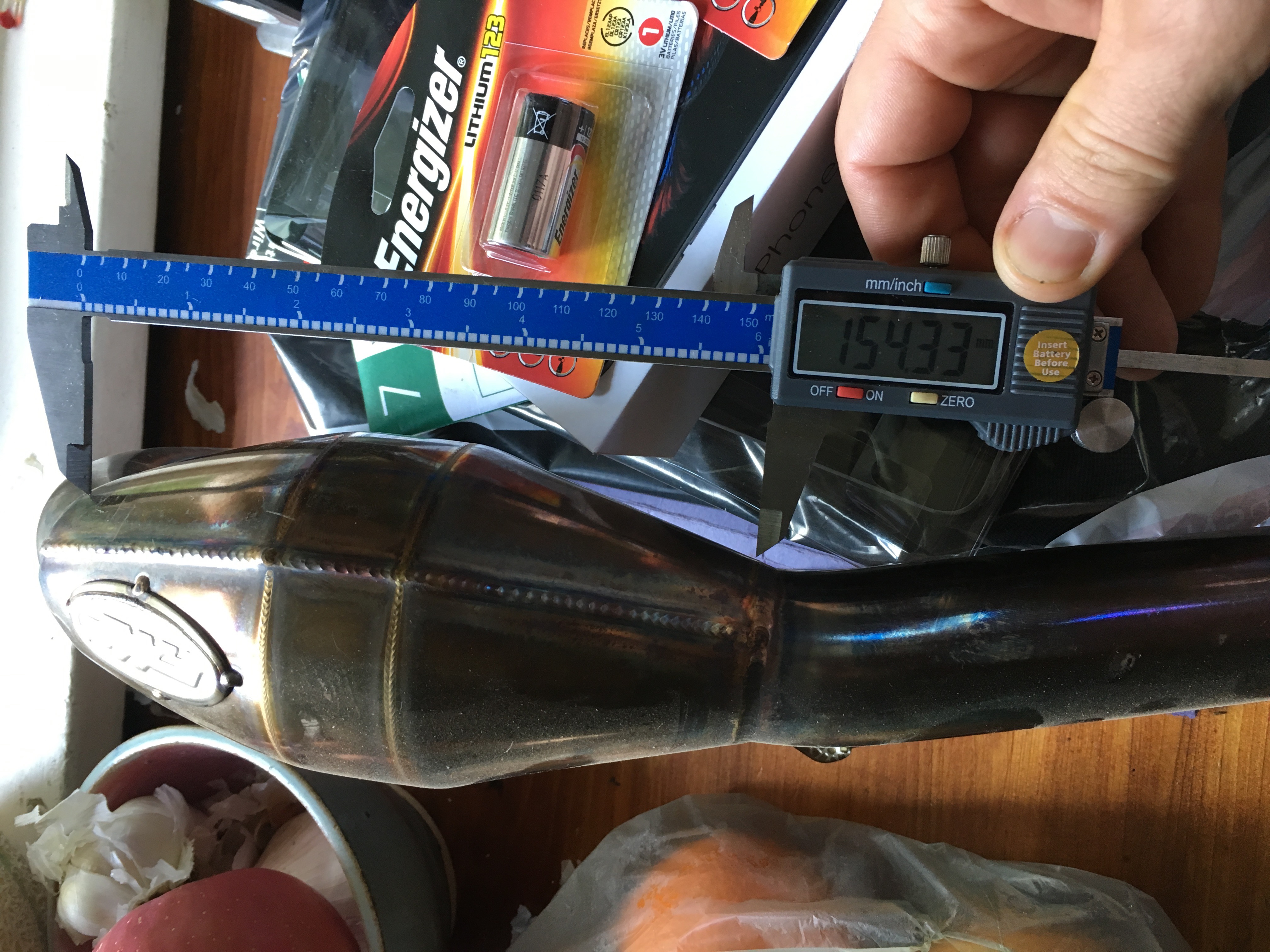

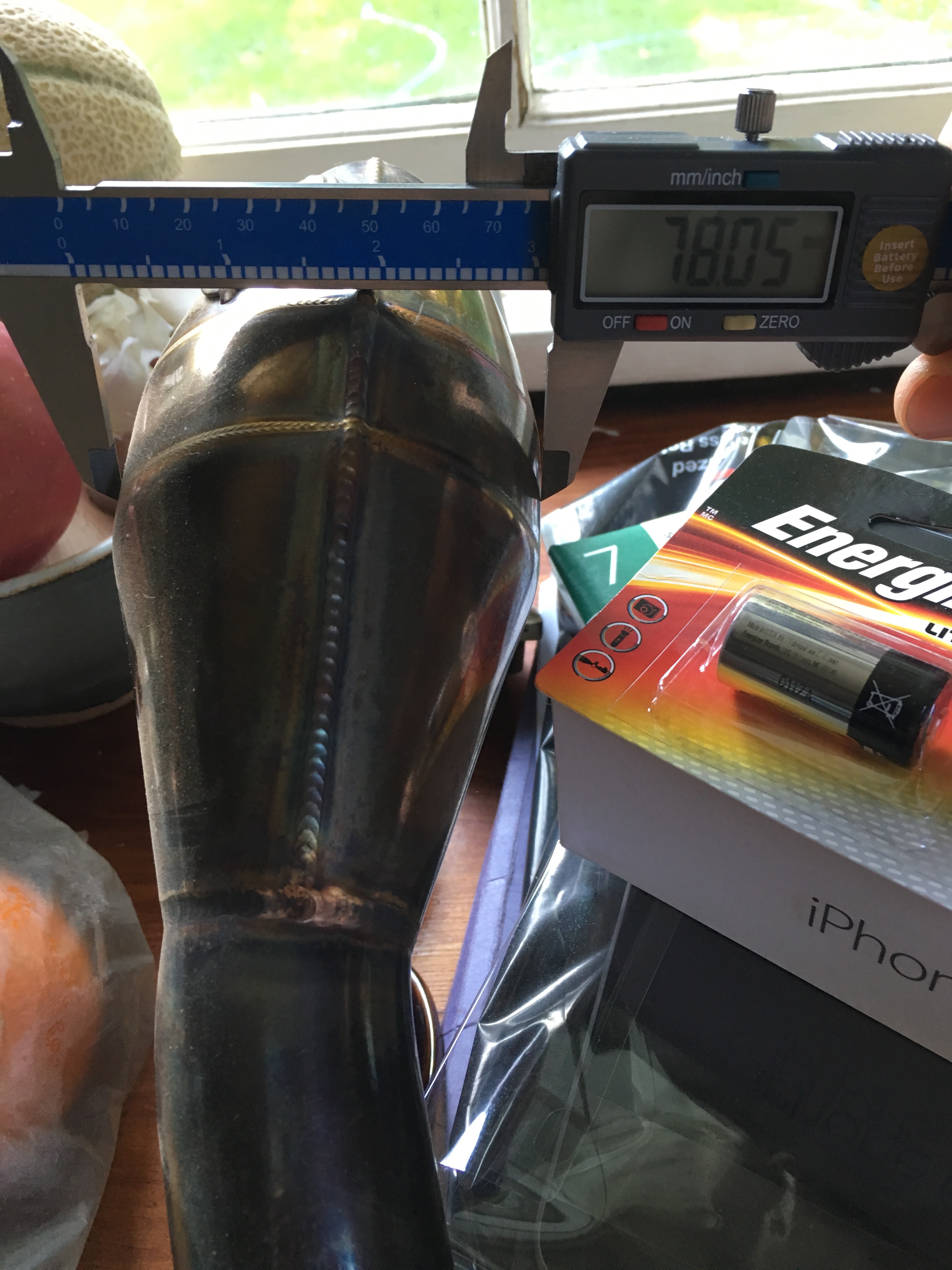

Originally Posted by Subseageorge
Can anyone give me the sizes of the bell on an FMF Mega Bomb,?
It also looks smaller than it should be .
Cheers
hope these could help. the overall length is a little shy as i ran out of length on the calipers but it is close
Attached Thumbnails Stock exhaust with FMF megabomb?-img_0046.jpg   Stock exhaust with FMF megabomb?-img_0047.jpg   Stock exhaust with FMF megabomb?-img_0048.jpg

Perfect, that is what i need ...
