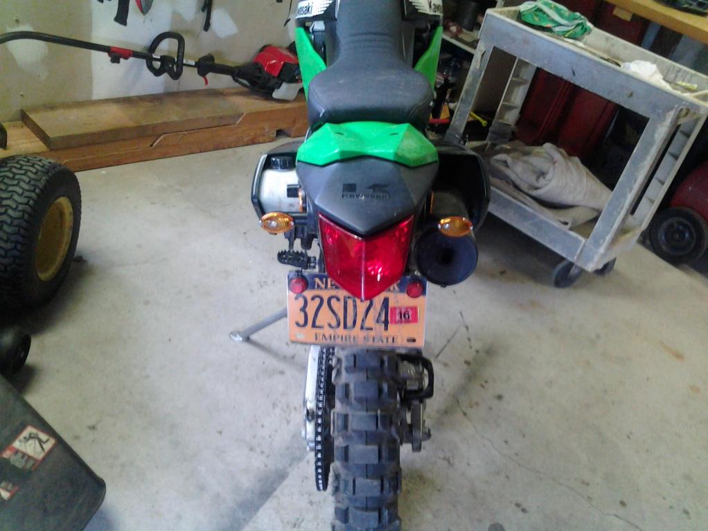

new rear signals
Attached Thumbnails What I/you did today on the bike-0531151108.jpg
