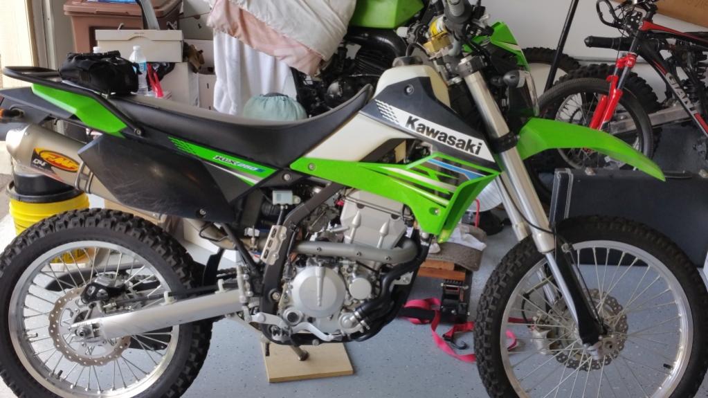

I just put mine back together after repacking the steering stem bearings. The manuf. didn't put a whole lot of grease in there. I cleaned everything up & repacked with Mobil One syn grease.
Steering is much smoother. I applied some silicone spray to the wires & cables so they don't make as much noise as they are stretched when the handlebars are turned.

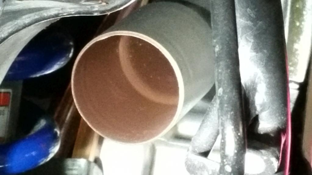

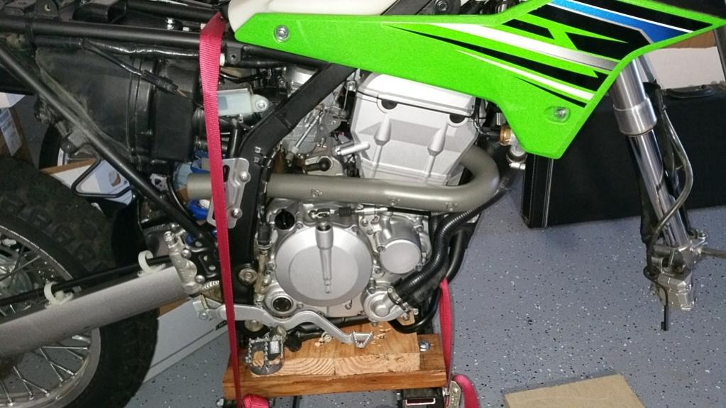

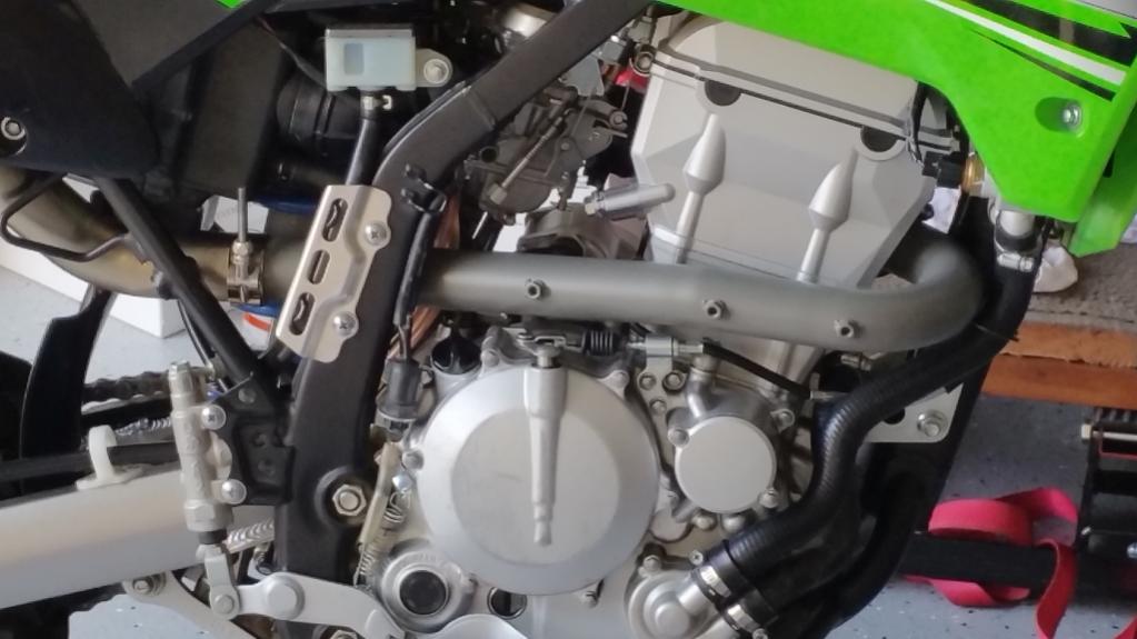

I also installed a new FSW header pipe which I had ceramic coated at Embee in Santa Ana. Turned out real nice and the coating is designed to dissipate heat quickly. The interior is coated with a copper material. I'm very pleased with the results. The stock heat shield does not look good on this pipe so I'll be making something cool to replace it.

Looks like that FSW header is carrying the same I.D. as the FMF all the way to the exhaust port..? If so, that's going to change the fueling needs - especially near sea level in OC..

Your bike klxter? Larger diameter does not nessesarily mean more flow, if the smaller diameter has a natural frequency in the rpm range of interest. Read about Helmholtz resonators and pipe tuning. Interesting stuff even if the math gets thick.

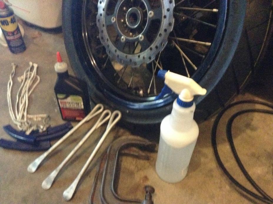

So I sealed each nipple with LIquid Nails sealer. I then decided to stretch the rubber rim strip over it then the bright idea I got was to use the flex seal to seal the edges of the rim tape to the rim. Did that and mounted the tire with much sweat and grunting of the bad kind. I think my next tire will go faster and easier. Time will tell if it holds air. Stan's notubes sealer will hopefully make sure of that. One hour leakdown test and I will get er rollin again.

Yes Helmholtz resonators are an interesting subject but don't apply to our KLX's in any way. We are stuck with the basics of high velocity stock headers or lower velocity/larger aftermarket headers and the usual effects that each has on TRQ production..

..a Helmholz resonance chamber can also help the "Kadenacy Effect" in a specific RPM range of the engine.
The Kadenacy effect is an effect that forms from pressure-waves in gases. In essence, careful design of the dimensions and position of the exhaust changer can assist scavenging of exhaust gases out of the cylinders and therefore increase the pressure drop across the intake and exhaust valve area within a specific RPM range. As such it could be used to increase engine performance in the engines' most used RPM range.
Red Bull adopts Helmholtz exhaust chamber - F1technical.net
Aren't the Akropovic etc pipes adding a little canister to some headers?

Ahhhh. Someone understood the pipe tuning comment I made. The best solution for intake and exhaust pipe would be to variable lengths in both. There have been experimental vehicles where this has been used on the intake but I am unawares of any on the exhaust. Cost prevents mass production so far. The boost in pumping efficiency is significant when the pressure wave returns to the valve when it is open, so a power improvement happens. This is why airbox design on high performance engines is important. A thumper is not excluded. There is power to be had from careful thought on our little bikes' pipe geometry.

You guys.. Starting up another Helmholtz/Kadenacy discussion.. Both are easily understood and examples abound - expansion chambers on 2-smokes(Kadenacy), resonator chambers on headers, auto mufflers, et.al. - but there is no data that either is employed in the design of any component on our KLX's..

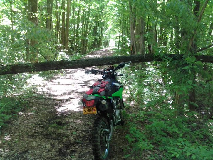

After this trail my turn signal disappeared, so new signals were ordered

Correct, from the factory there is not.
