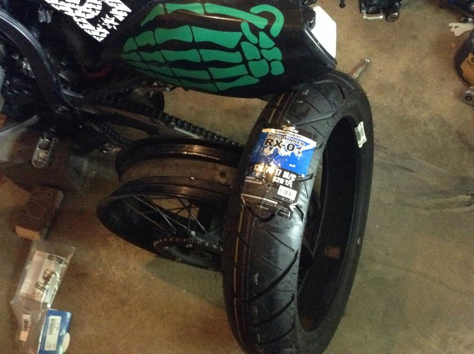

I am surprised not to see a sticky thread on what you did today on your bike. Maybe this is the start. Today I wrestled the rear tire off my SF. My very first motorcycle tire removal. Stock/OEM shoe 130/70-17. Ran out of time because I gotta go to work. Thinking about ditching the inner tube. Tubliss does not carry a product for SM wheels, I asked them. I have seen a video where a guy in the PI uses some roofing mastic or something to make a tubeless rim spoke hole seal. I was considering masking off the inner sides of the rim and spraying in some of that Flex Seal product to make the tubeless conversion. I am thinking that if I clean and roughen up the surface the flex seal will bond well and be pretty easy to use too. Anyone try this?

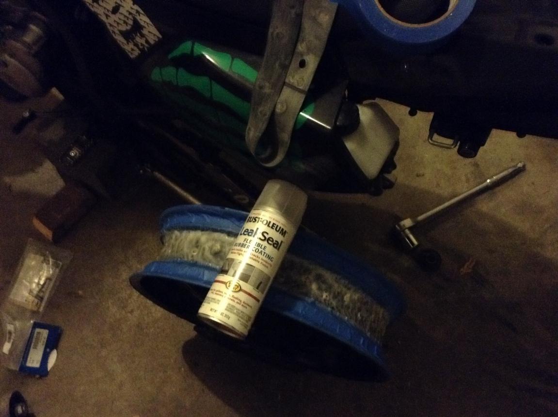

Sprayed on some rubber sealing stuff. 2nd coat tonight. Think I will lay on the entire can, maybe do some testing, then mount the rear tire this weekend. Hoping for a cheap and easy DIY tubeless conversion.

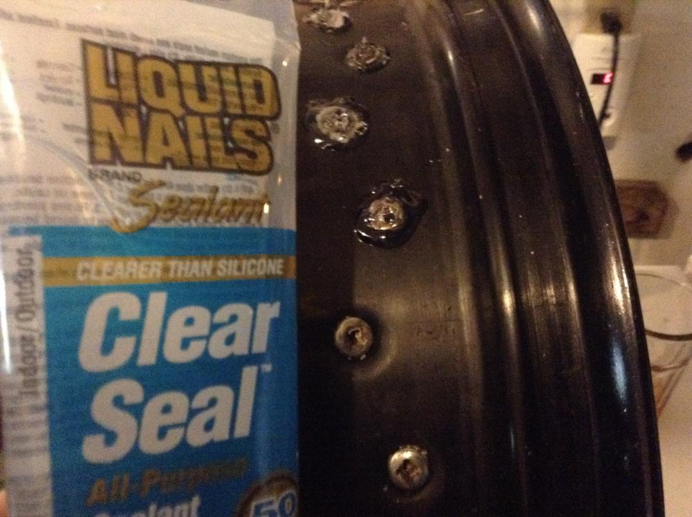

After two coats there is still much porosity around the spoke nipples, in the flex seal type of sealant. So flex seal is out and the new tubeless spoke sealant is by liquid nails. Drilled out the rim to fit the 90deg tubeless tire valve stem. After all nipples are sealed and dry I will install the rim strip and spoon the tire on tomorrow.
