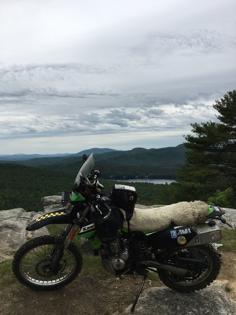

Rode to the top of a couple of mountains. OK, it was yesterday. Today I'm putting on a new rear tire and replacing my Edge tail light with a new one(a bunch of the LEDs are out and it won't pass inspection).

Nice light bar set up

The light bar is awesome. The brackets not so much. They are hack job but work so well that I've never taken them off to paint them.

Love the look of that bike
May I ask, is that an extended fuel tank or an extended coolant tank on the rear?
Also, where did you get the windshield? And does it help much?

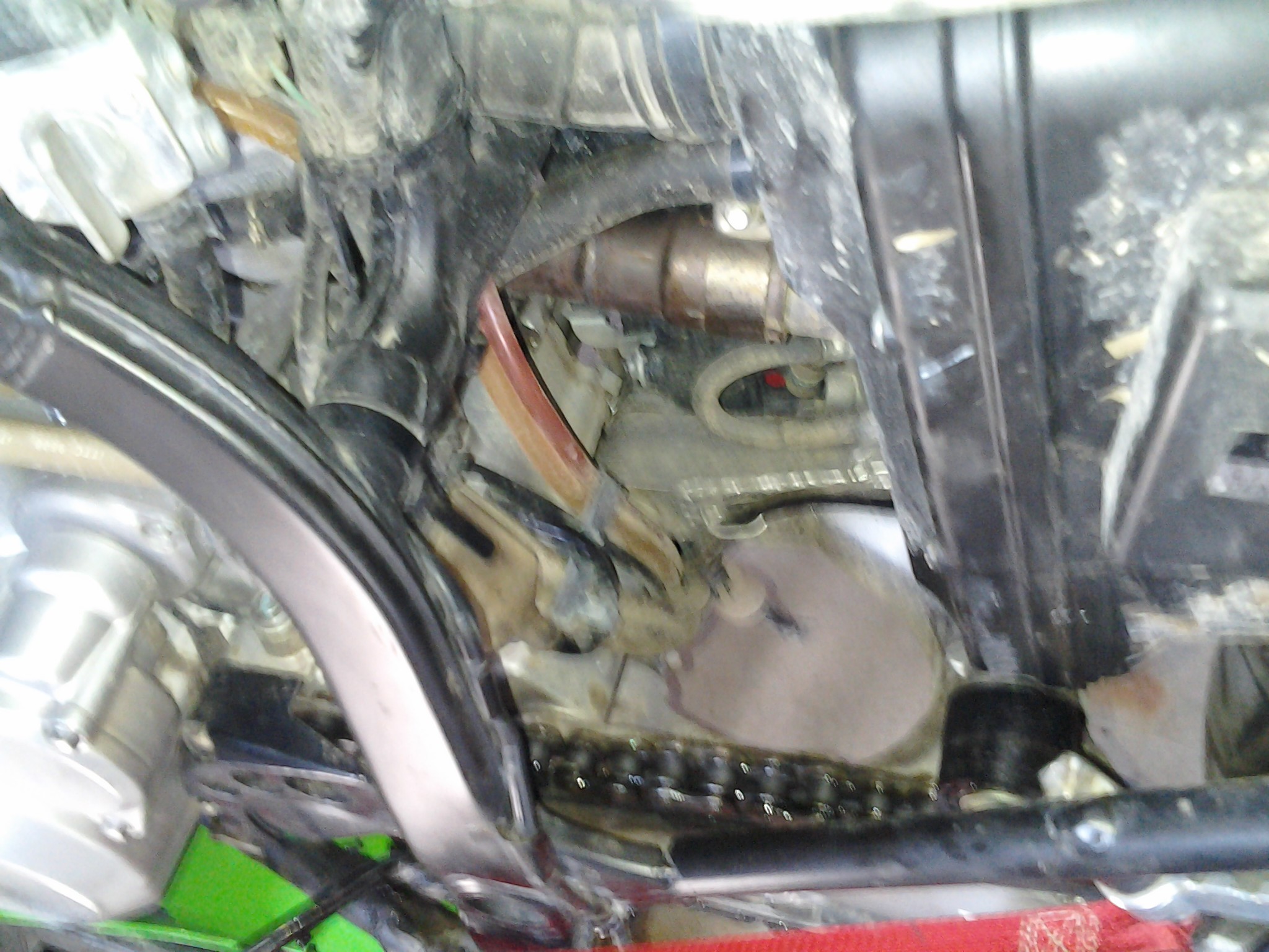

Installed racetech 6.4 rear spring, what a pain in the *** that was!! Didn't know you had to pre load the shock 1-2 inches to clear the intake. I really hope racetec recommended the right spring or ima be pissed

That is a Baker Distance tank, it holds an extra 1.1 gallons. I'm pretty sure he stopped making them years ago. I had to lose the coolant bottle to mount the tank, meant to relocate it, just never had the need.
And the windshield is great for commuting, it really keeps the wind off me in cooler weather. It's off my old EX-500 and has been heated and bent to fit a little better.
It should have come off for spring, it sucks to have it on when off-roading. It's too tall and I often have to duck to the side or get hit by it on big bumps.
