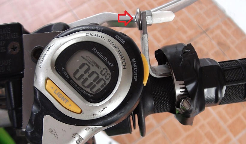

Along with any mod you'd need to be able to do accurate testing. That stop watch bolted to a plate on the R.H. mirror base and activated by a piece of metal affixed temporarily to the throttle was a huge advance for me in knowing if something worked or not.

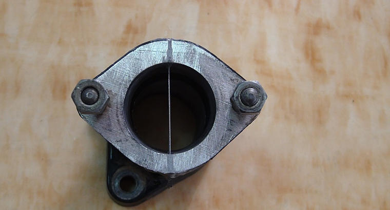

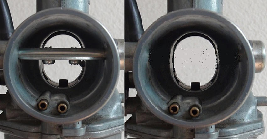

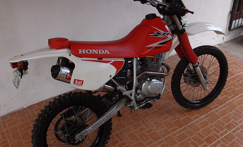

On my XR200 I found it a bit quicker with a vertical divider in its intake; then I sawed about an inch and half off the Al muffler case-shortening the OAL of the exhaust, and picked up a little more sprint power. Times dropped from 6.53 to 6.41 with those two mods. That's a nice gain in a short distance sprint.
But, removing the choke slowed the bike to mid 6.50s again!
Your brain says it'd have to be quicker without all that junk in the air stream, but the automatic on/off stop watch doesn't lie, and it allowed me to do testing by myself without the expensive instrumentation I'd been eyeballing. There's a change in pavement level at the end of where I test, so I back off the throttle when the bike hits the dip. Testing starts from a 17 kph roll at a specific point on the hwy in 1st btw.
