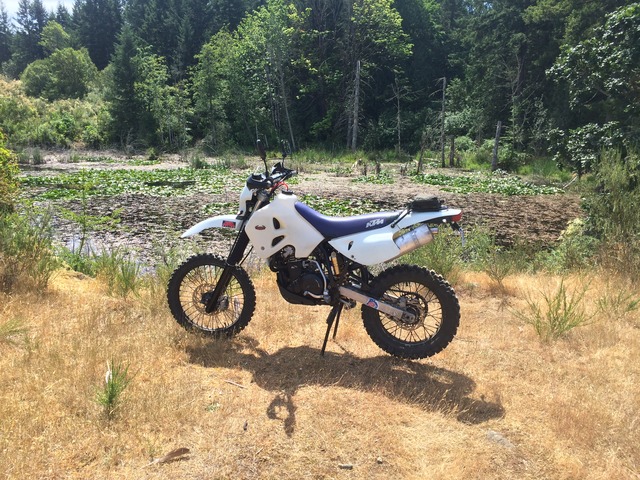

Today I cleaned my 2014 250s, I'm trading up for a highly farkles, low mile, 08 klr650...my 250s a great bike to get my license with and get into dual sporting. But I've always wanted more...que the ktm 400 rxc,
The ktm had a recent frame up restore and is running great!!
