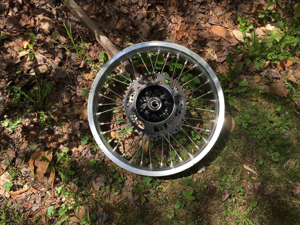

Managed to take 2 bad wheels and make one good one.
Used a spoke kit for a KDX wheel. I had to drill out the spoke holes to use the nipples that came with the kit.
Re-lace took about 45 minutes and another 45 for tightening and truing.
Put a double layer of Gorilla tape on as a rim strip, mounted a tire, and went for a test ride.
75 miles later, I jacked up the bike and rechecked spoke tension.

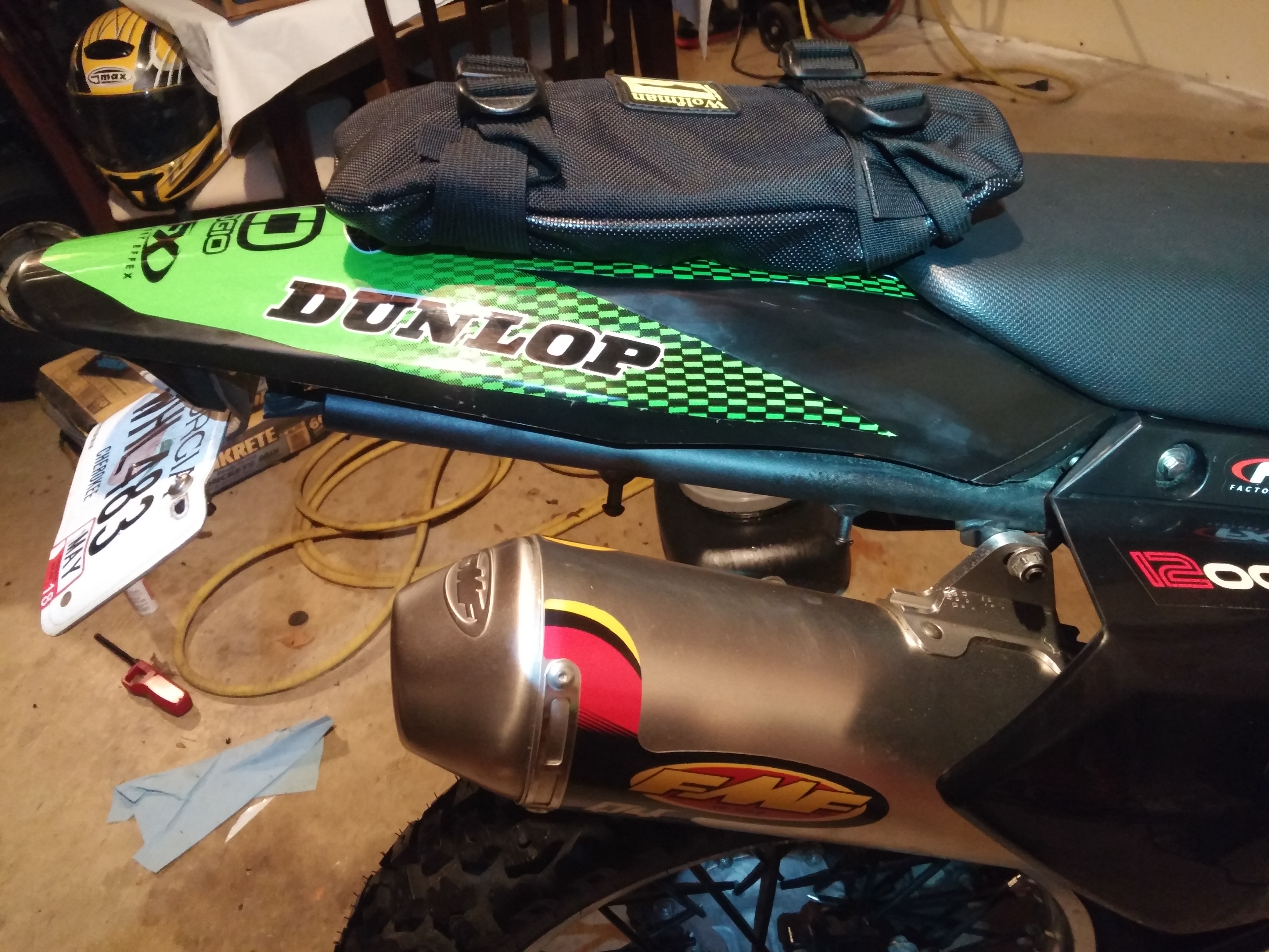

Put some factory race team graphics on my rear fender (kx450f fender), except I cut the white out of it.

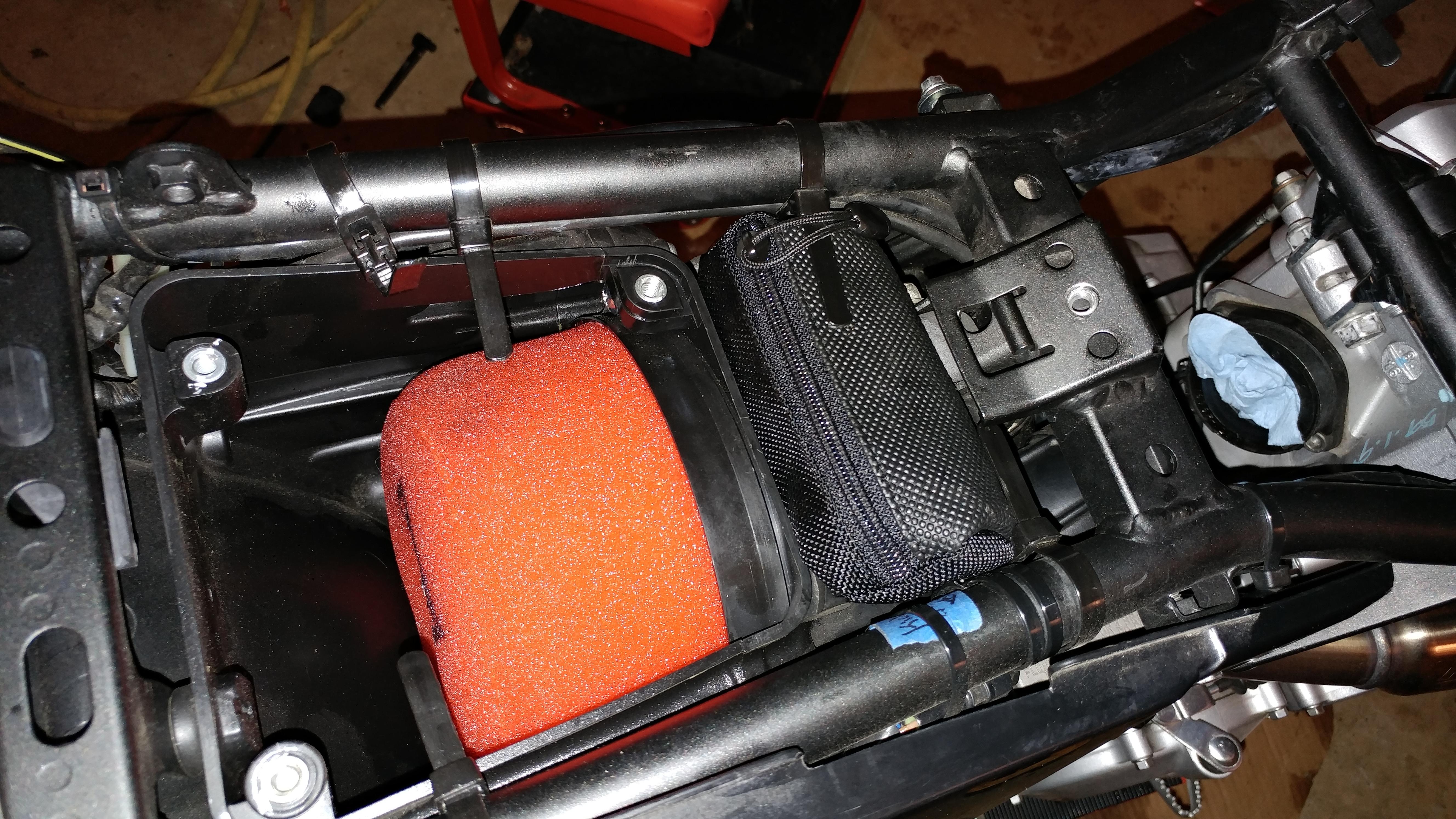

Found a nifty spot under the seat in front of the airbox for a small storage bag, i keep a CO2 inflator in there and a few co2 cartriges. I think the bag is a little accessory bag i got off an otterbox case for an iPad. Hey it got some more stuff put of my backpack. Im happy, you could probably fit a spark plug andba fuse or two in there also

What might be the effects of this mod to airflow ( airflow to the airbox ) ??
Old Jun 2, 2017 | 07:55 PM
  #237
jabara572's Avatar
Joined: Mar 2017
Posts: 180
Probably nothing would be my guess.... the "hook" for the seat goes right there and the bottom of the seat almost seals off the front of the airbox anyway, plus there is a big piece of frame and shock there already.
Maybe if there was some of "ram air" effect that may have been happening then maybe, but i doubt it, if anything it probably blocks some hot air coming off the engine from going into the airbox.
I guess the airbox gets its air from the space between the top of the box and the bottom of the seat (pretty terrible design IMO), which this bag doesnt affect, so I dont think it would affect flow rate through the filter at all but i dunno...
