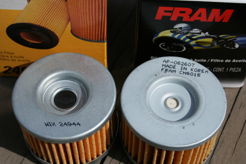

hahahahahahah , WOW, Thin skin.
Wix and Fram . As TNC said the "closed " end has some sort of one way relief valve.

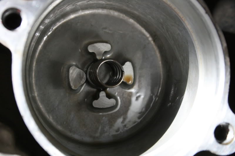

Bend the spring open a bit, make the diameter larger, and stick that end in the bike. You will never touch it again.
