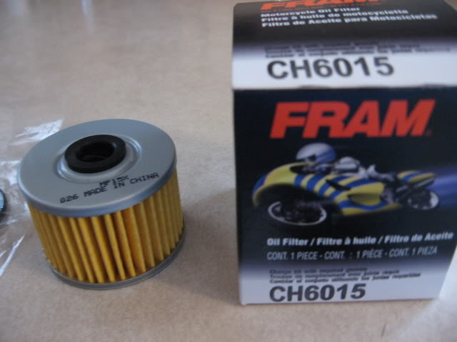

The black rubber can seat against the engine or the oil filter housing cover.
I want to know which. Because I'm SURE it only works one way.
These are not the screw on type filter. They fit under a cap and have a spring to push them snug.

Black gasket faces engine --- fits fine
Black gasket faces filter cover --- fits fine
Just need to know which way it should go --- Just so that it works and doesn't block the oil flow and burn out the engine.

Seriously.. Just look at it. One side is metal with no holes - with an indent that sits against the spring.
The other side has a hole, with a black rubber gasket.. What's weird is that the oil filter cap has a small "tube" part that fits perfectly into that rubber gasket/hole on the oil filter.
So, by power of deduction, I would say that those two pieces fit together, and the oil filter should be installed with the hole/gasket facing outwards.

So you bought a box of pieces at least worth 400$ and you are trying to put it all together without a manual? Its just such a basic question, one should be able to figure out, at least i would hope so if you are trying to put the motor together.
this is what the oil filter looks like....
It only has one hole. The other side has an indent for the spring, but no hole. If thats not what yours looks like its wrong. Maybe if you would have given more details we wouldnt have replied like we did.....

Did you get your filter figured-out, or still have a question?
(EMS, the Fram filter is for illustrative purposes only, right? You don't actually USE a Fram?)

MAD DOG, which filter part & brand did you buy? Sounds like it isnt the correct one. Let me know so I dont end up buying it. The one I bought kind of looks like the one EMS showed.
Remmber to put a little bit of grease on the spring before you put it on the back of the oil filter, this will allow the spring to stick and sit in the both areas correctly.
