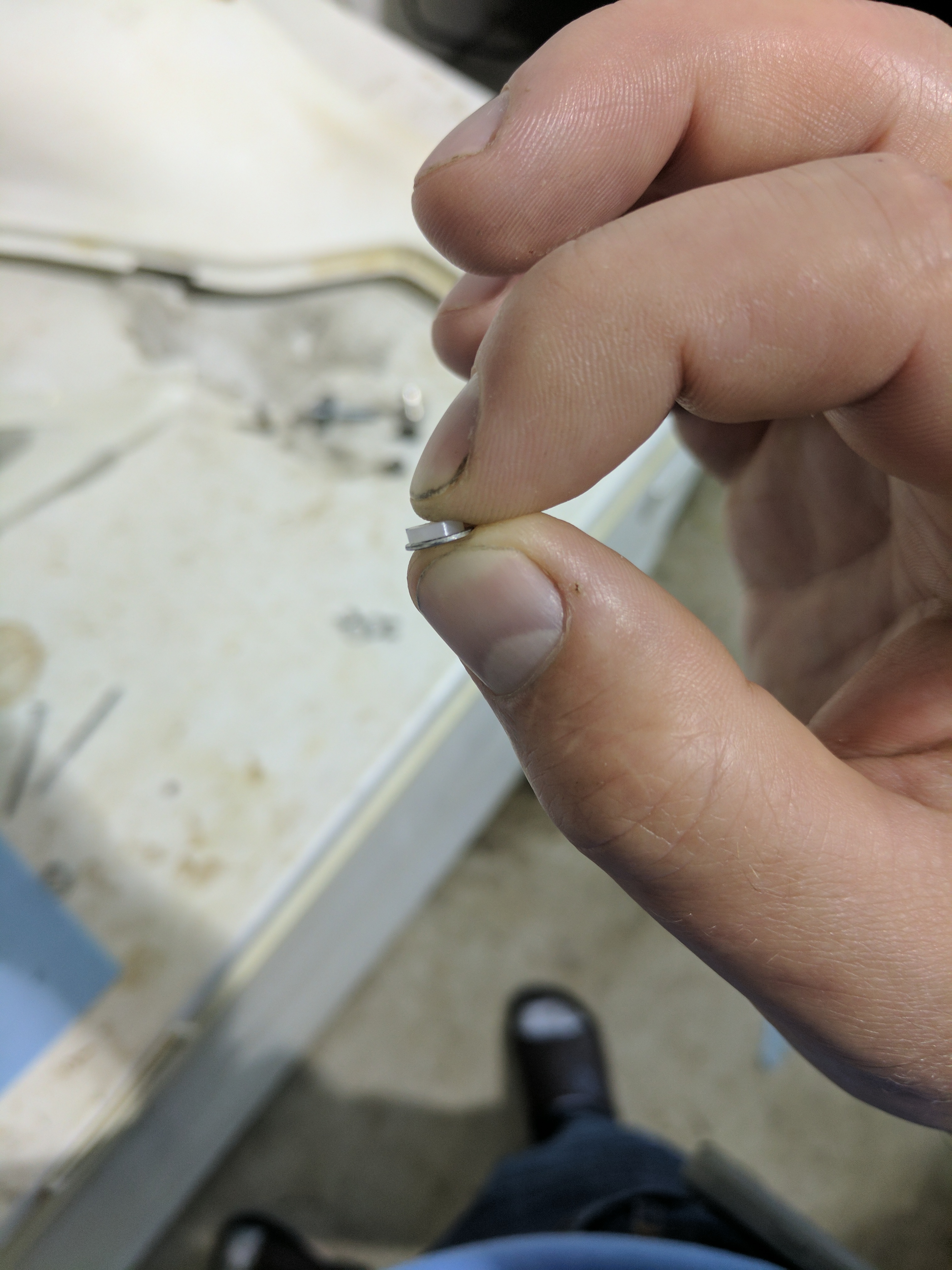

I do not know about your needle shims that came in that Sigma kit, but I can tell you that you need to shim the stock NNLA needle with a "spacer" that is between .020" and .040" in thickness, for this lidless recipe - do no go thicker than .040" - obviously place this shim pack below the needles' retainer. This means stick the pointy end of the needle into the shim pack and slide the pack up against the retainer..
It ain't much shimmin needed here.. Do not go overboard..

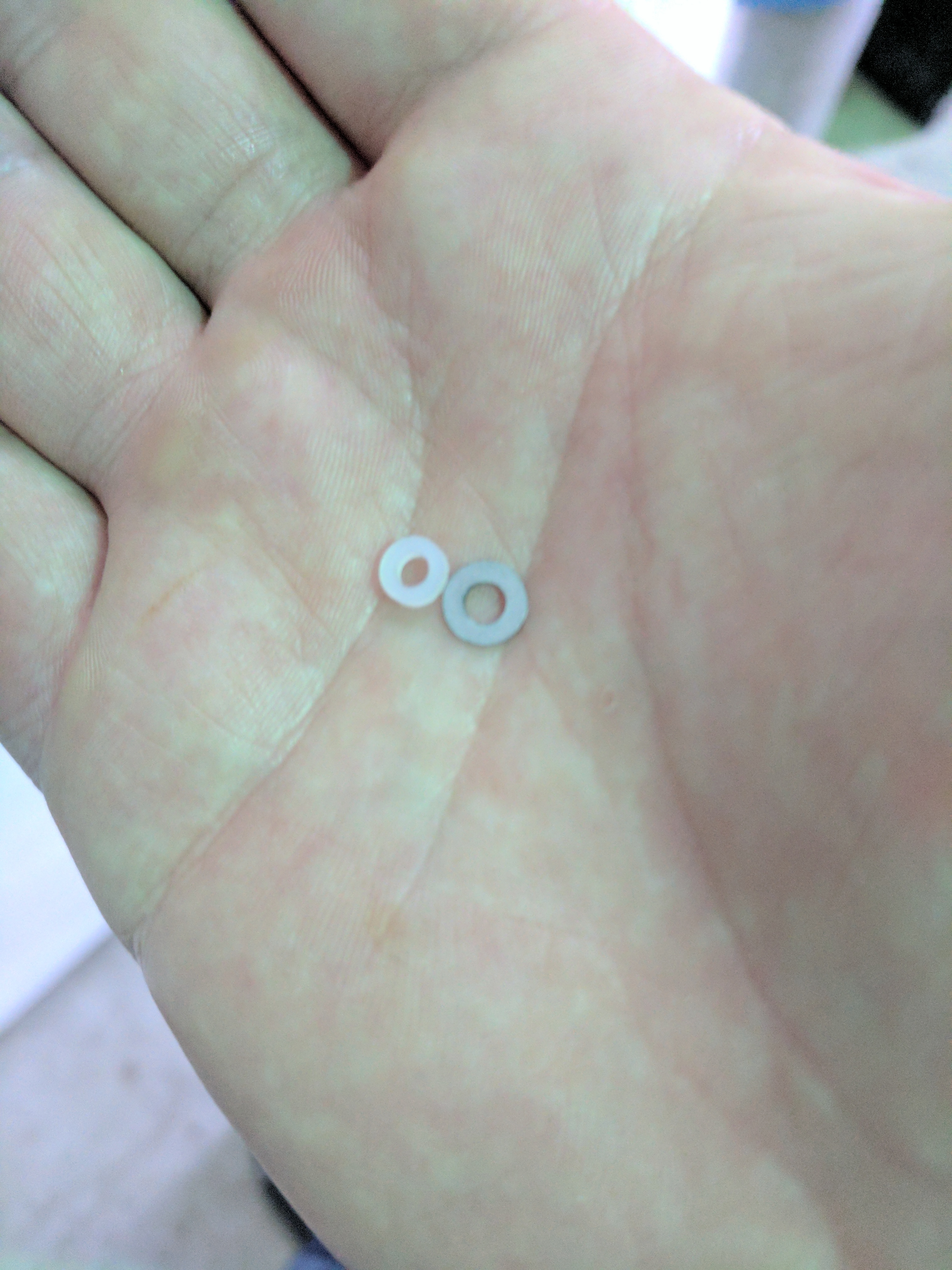

being that i'm located so close to ASL, should i look to shim this even further than the 2 currently on the needle? what issues am i looking at with an "under shimmed" needle running the 158 main jet + lidless+exhuast, still a lean condition? if i'm understanding correctly the shims are effectively bringing the needle up, allowing more fuel to flow.
the instructions on my kit compare one shim as equal to 1/2 clip position.
The thickness you are looking for is two of those metal washers worth.. This should insure good throttle response and power ramping from low RPM's - and good gas mileage if you are into that.. If you like to work on your bike, tuning work that is, you can play with increasing the shim pack a little at a time, over time..
