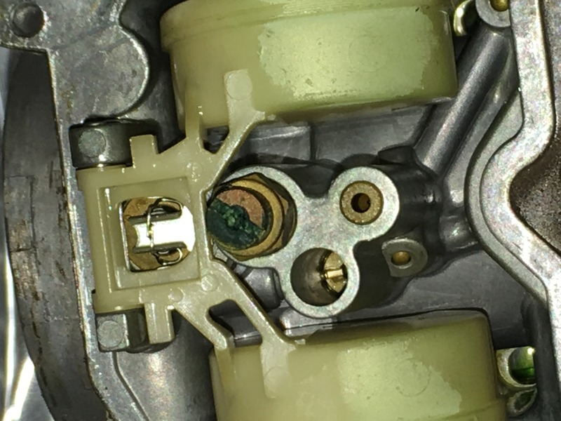

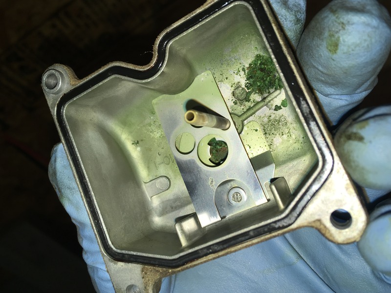

Yeah..it was really clogged up in there. Surprising it even ran, tbh. Anyways, I set to taking it apart and cleaning everything out really well. Every screw that could be removed, was. For the jets, I took caliper depth measurements and made sure they were installed back to the same depth, protrusion. The one exception was my main jet. I wrote down a value of .433" protrusion from carb face, but also noted that it was hard against the carb face. When I re-installed it, I snugged it against the carb surface and was puzzled by the measurement of .334". My first assumption is that I wrote the initial depth wrong....I tend to be dyslexic when I'm in a hurry
The main jet and jet holder were plugged up rather bad. Being a machinist (back to that "self-employed" comment), I do have my own set of very small gauge pins so I was able to poke out all the crud without doing any damage to the jets. (The main jet has a #128 on the bottom). Interestingly, the needle has 3 washers on it, and I've only seen mention of there needing to be 2 washers/spacers

Looks like you have a lid of weed in your carb, was it from south of the border?
Sounds like a diaphram issue, did you boil the carb? With that much weed in your carb, it may reclogg unless you get all the passages cleaned out.
