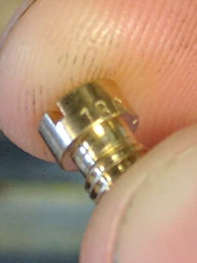

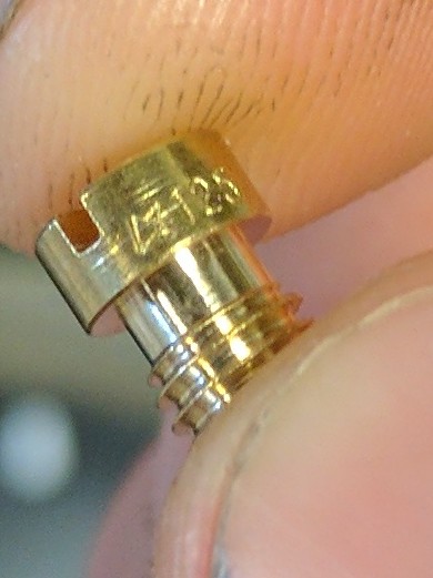

Did you look at the jet for markings? That is the first thing I'd do. From there the only way to know is to accurately measure the orifice then look up what the others have.
I am still betting those are common jets. Here is a link to Jets-R-Us conversion chart and an image.
Look and see. Keiin mains commonly used for the KLX250 would be in the 125-140 range. I run a 125, brother runs a 138.
thanks for the pic and info. yes i did look at them, and the plot thickens- the 125 jet has the K but the 130 and 135 do not. they all appear to be the same type of jet though... i messaged the seller asking to confirm.
Originally Posted by Klxster
BTW, do not pull off the airbox lid until you have installed a DJ144 or K158 main jet.. Stay on the proper course with these mods and you'll be fine - go off half-cocked and you'll suffer..
do you think i'm ok to run the lid with kdx snorkel with the 135 jet i have in there now along with the full exhaust?
Attached Thumbnails jet change, i done messed up. help needed-img_20170711_075235.jpg   jet change, i done messed up. help needed-img_20170711_075302.jpg

Well, if you must reassemble and run right now, I would put in the "unknown" 135 and, just to be safe, I would use the lid and KDX snorkel. Shim the stock needle if you want.. Certainly stay away from high RPM's if you are near sea level..
You do not have a proper needle for any "high performance" use, except what I mentioned before. Combined with an unknown main jet, this is a bad situation.
DJ jets for our bikes do not normally come in odd denominations. DJ jets cannot be compared to others via "hole measuring". If that 135 is a Keihin or similar, it only x-overs to a DJ126 - far too lean..

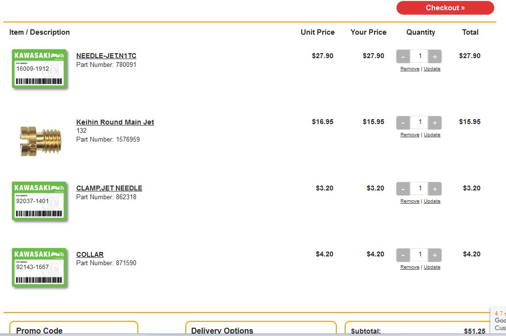

Seems the most economical way to go is to keep doing the Keihin stuff, pick up the N1-TC needle and a couple richer main jets, the pilot is pretty much by the book for Keihin.
getting 1 jet, needle, clip & spacer comes in @ $52 + shipping @ bikebandit... got scared looking for the right jet @ jetsrus

Sounds good.. That N1TC needle has always been waay to expensive.. I assume you are going to be riding below 2000 FT ?
