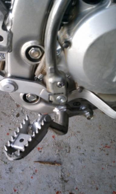

I will agree with TNC that this bike is already too low and I only have a 32" inseam. Perhaps it just has a fat belly since the seat height is pretty high but the belly hangs low enough to put a good amount of damage to the skid plate and to bend the hell out of the footpegs. For off-road, get used to the height, this bike is not too tall. For on-road, sure, lower the heck out of it.
