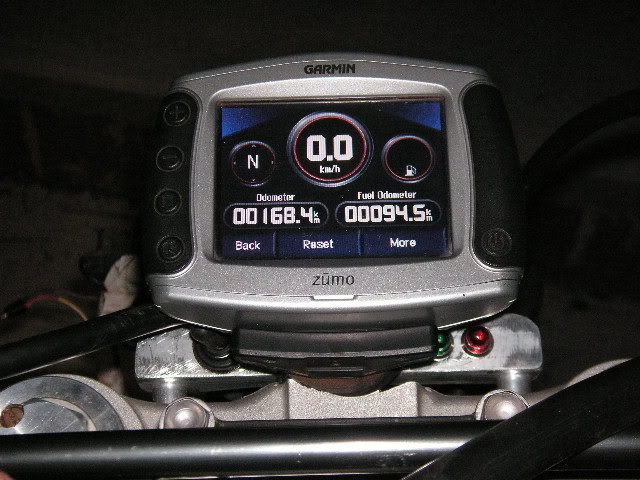

In regards to the GPS and a speedo.
The Zumo 550 has a great speedo with trip meters and a sort of fuel gauge.
(You need to program your range and it calculates from there)
(I don't use it)
But, and it's a big BUT, no practical odometer.
It's got one but it's resettable and meaningless if you use the GPS with other vehicles. (and I do)
And I'm fairly sure that here you must have a working odometer on a road registered vehicle.
I don't think it's something that a policeman or ranger would worry about, but when selling the bike it might be a problem.
It's some sort of crime to interfere with an odometer which includes disconnecting it.
But heh, your a long time dead right?
It's not the crime of the century granted.
