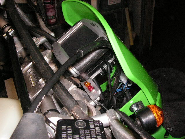

In my attempt to reduce weight, I removed the fan and mounted a indicator lamp, amber, on the dash that would light up if under normal conditions the fan would have come on.

Today was not a warm day, 12-15C.
Never the less, after 20 mins of really tight stuff the lamp came on for about 20secs.
Once a bit of air flow was established, it went off .
The thermostat goes off at a slightly cooler temp than the temp that turned it on so even though the the fan stayed on for 20secs, It is not likely that the temp rose too much.
On temp is 94-100C and off is 90-93C.
The red temp lamp did not come on and the amber lamp only came on the once.
Conclusion?
I think i will put the fan back on.
If it was required today, which was quite a cool day, then IMHO it is important.
Plus it's not as heavy as it looks.
If you could keep the speed up then maybe it isn't needed but I enjoy some really tight riding and therefore I need a fan.
And sometimes you can get stuck in difficult terrain and it can take awhile to get out.
Simply put, IMO it's not worth the risk.
