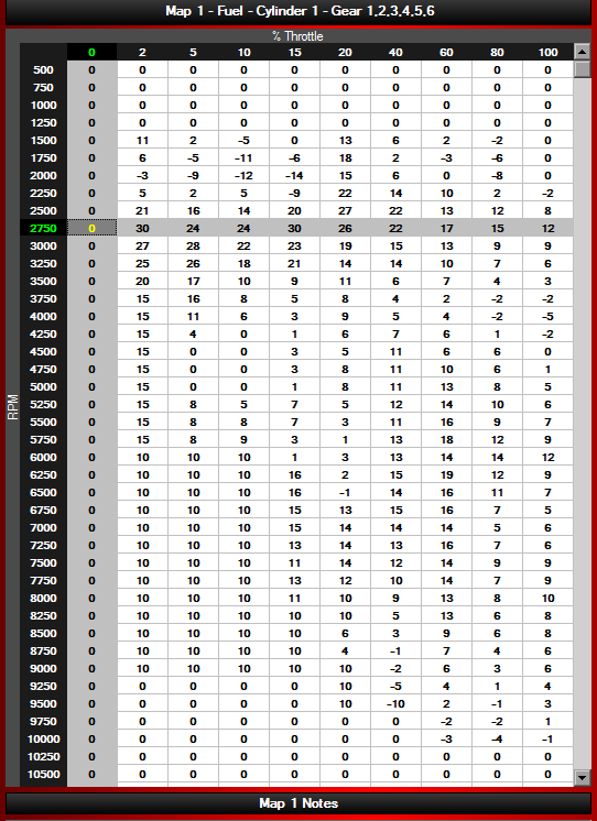

So that amounts to +4% below 3750rpm, +8% up to 7250rpm, and +10% up to the top.
I don't suppose they told you when they'd be getting any proper dyno tuned maps for this thing?
See attached map of the euro bike with leo vince pipe and no air filter (of course euro base fueling is probably different, so I wouldn't base a map on that)

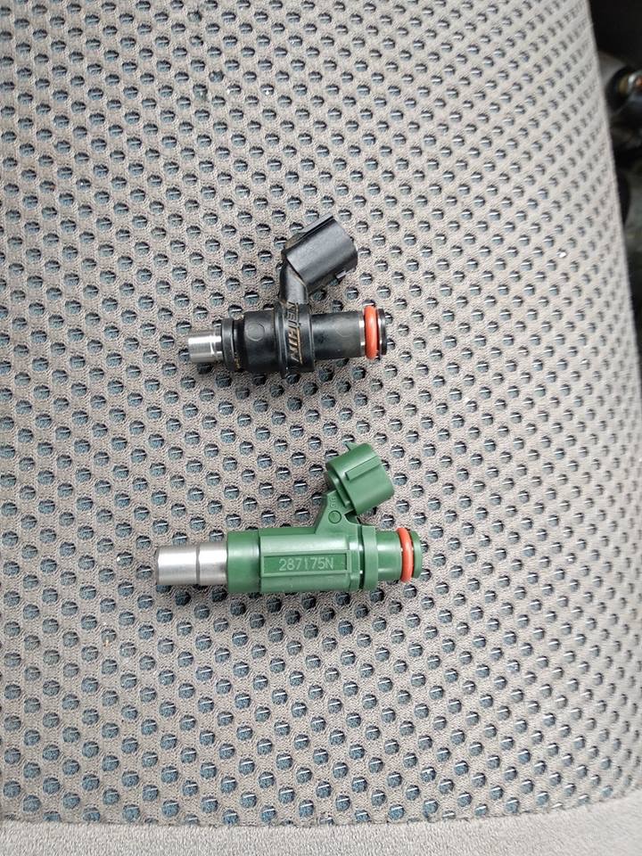

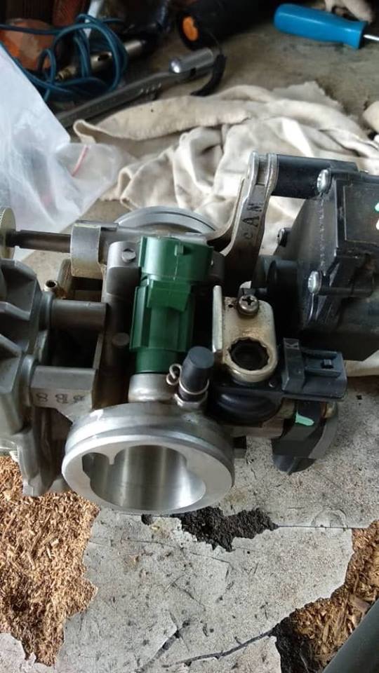

Thought I would drop this here. Might be of interest.
A local guy just posted on Facebook about his AHL 300cc upgrade. He swapped the stock fuel injector for a Ninja 650 injector; stock ECU. So far no problems to note, though it’s still early.
No idea of what year his bike is or any other details other than an Asian KLX.
