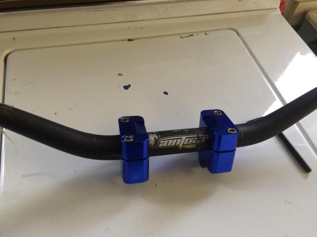

I won a bid on eBay for some pro taper contour yz high bars, then bought some cheap anodized blue adapters and mounted up the bars, I like them, gives the bike a more dirt bike feeling, probably just in my head

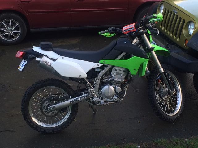

I also bought and mounted a trakmaster 2 front tire, still debating a mt43 or TM2 for the rear....hmmm. I finally got around to replacing the rear turn signals with some eBay LEDs. Stripped of the stickers and factory graphics, I'm contemplating some MX graphics.

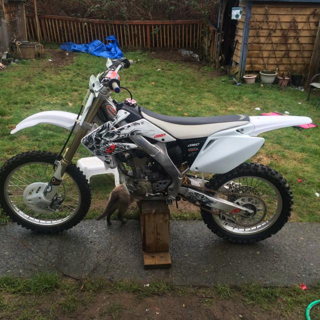

Also I bought a 2007 crf250r to race in the hare scramble series locally, so I've been prepping her for racing. Good times!!
