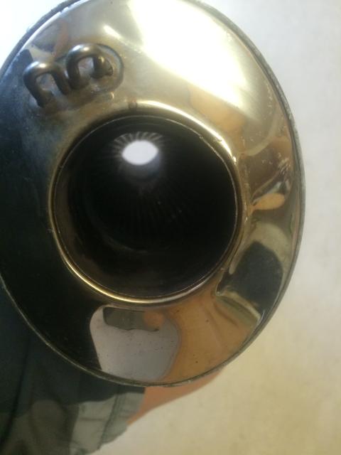

edit: By the way, which slip-on in the pic? It looks like my old HMF with the tag ripped off.

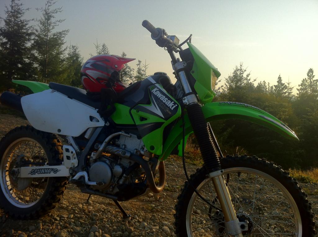

That is a very fine looking DRZ....er KLX....er DRZ in green. Mine has more than a few scars....well earned and well deserved. Its life is almost off-road and has made me feel like J.N. Roberts at times. (look him up!)

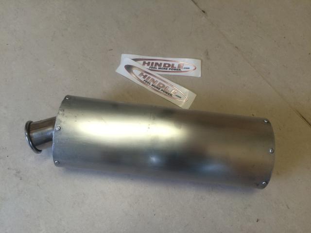

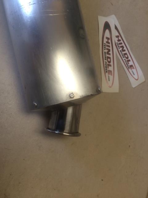

The silencer in the pic is the hindle slip on I picked up for $50
I'm polishing it up and refinished the mid pipe....I can't wait!!!!
