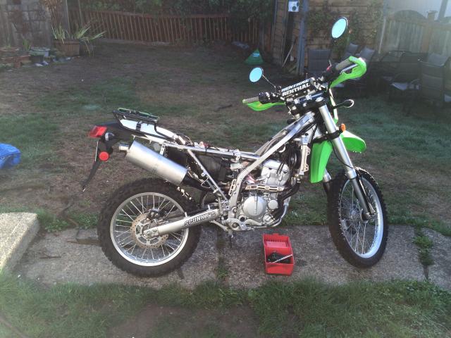

Ok...update!!
Installed the hindle exhaust, it took some elbow grease to get the mid pipe inlet to fit into the header outlet, but she is together!!!
I'm currently doing the rejet...question; when I drilled out the A/f plug the a/f screw was completely tightened in...I thought this was strange??? Any way i backed it off 3 turns and installed the needle and 128 main, going in now...stay tuned!!!

As she sits now!

The screw shouldn't have been that way but you don't need me to tell you that! Probably won't need choke for as long on a cold-start and respond to crawling-speed throttle a lot better.
I'm keen to hear your impressions of the jetting changes, our KLX came with the kit already installed.
My guess is that throttle response will be improved, especially 1/4 to 1/2, but I could be wrong(as usual) and that there is a little bit more power from 1/2 to full throttle.
Ok, made predictions, what did it *really* feel like?
