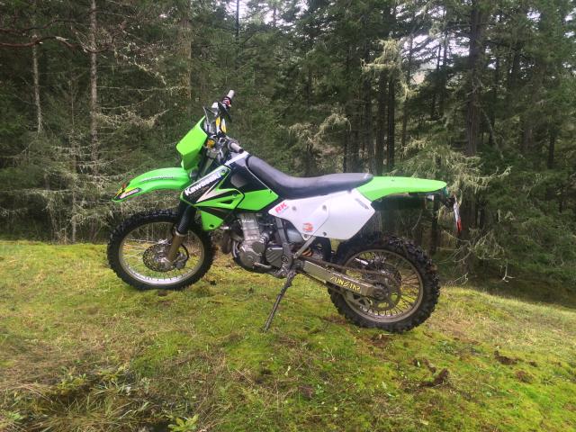

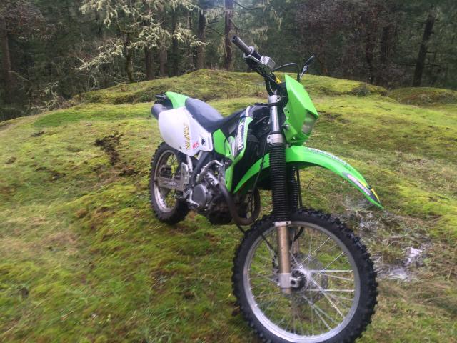

I'm gonna start street legalizing the kxl400, but first the carb needed a DIY uncorking. I shimmed the needle with a 1mm spacer, drilled out the a/f screw and I'm at 3 turns out, I also replaced the diaphragm spring with the stock klx250 spring and removed the snorkel...no 3x3 mod until I get bigger jets. I took the 400 for a quick test ride and it runs much better, throttle response is crisp, no lean out pop wihen I spike the throttle, top end seemed to pull harder....stay tuned
My 400

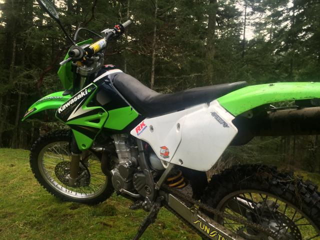

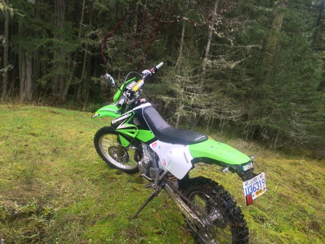

My 04 klx400, new TM2s, e gearing and pro taper atv mids
