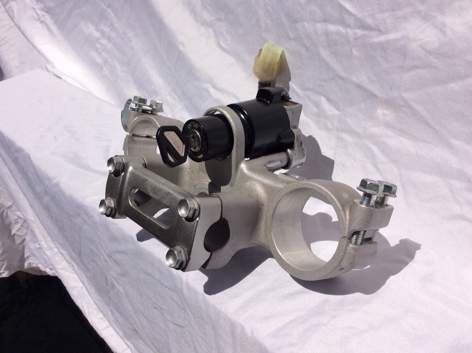

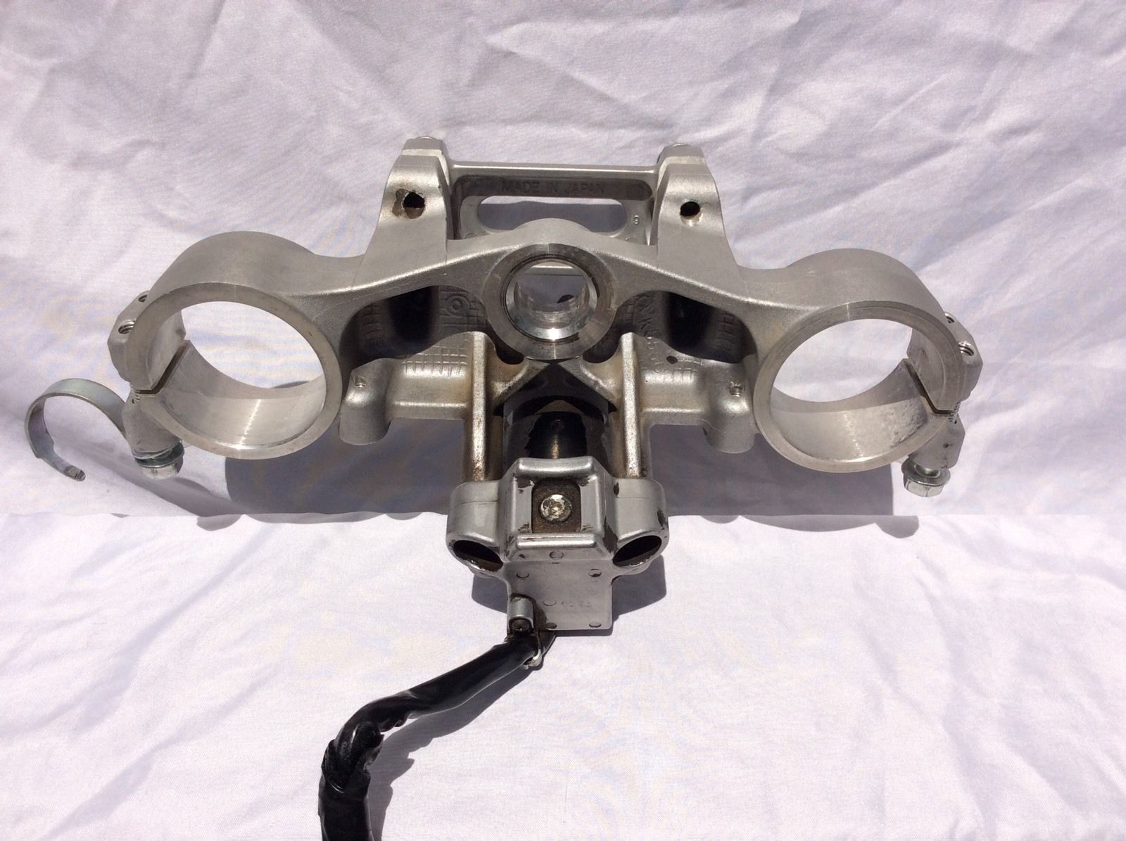

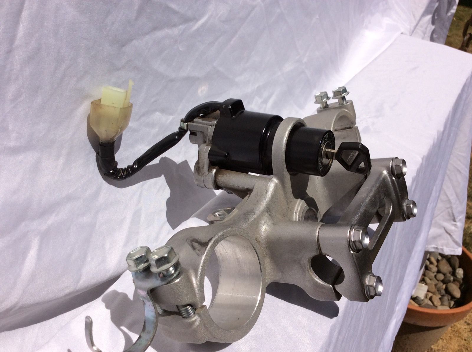

Second guessing whether the Zeta will work. Looks like it is "universal" how the keyswitch mounts up.
Here is the first gen OEM top clamp and keyswitch.

Zeta replied:
Thanks for your email and your picture.
It does not mount key switch low like OEM, but we change location to fit the key cylinder.
Until I see a KLX250S running a Zeta top clamp I'm gonna pass and use the adapter right above.

Looks like they use a plate to mount the switch-as always, security is only as good as the determination of the thief.
