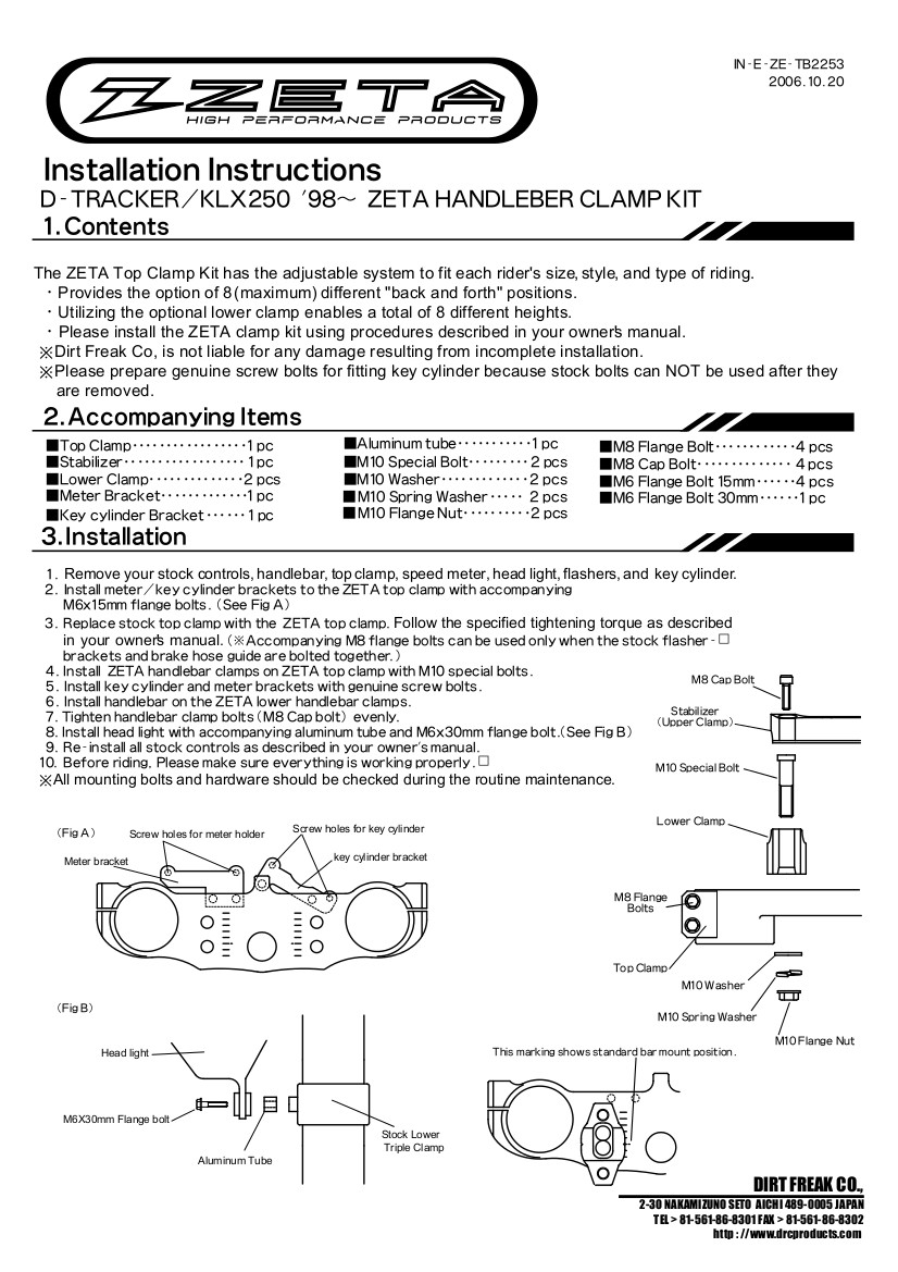

Good find but will it leave us without a place for our keyswitch? I realized after posting this thread I can't upgrade top clamp if I lose my keyswitch mount.
The reason for my post is I am looking for a sturdier way of bumping up to 1 1/8" bars. I've used the handebar adapters and risers for decades so they do work.. just looking for something a bit more beefier at the base.
Old Oct 26, 2016 | 01:40 PM
queen of spades's Avatar
Joined: Apr 2016
Posts: 389
I sent Zeta an email to inquire. Maybe someone there knows.
ZE11-2254 KLX250/D-Tracker '08- $243.95
ZE11-2253 KLX250/D-Tracker'98-'07 $243.95
Old Oct 27, 2016 | 11:29 AM
Joined: Apr 2016
Posts: 389
Here's what Zeta wrote back with:
Thanks for your email and your interests for our products.
Yes, you can mount key cylinder and head light on our top triple clamp kit for KLX250.
Attached is a copy of instrcution, please confirm.
If you have any questions, please do not hesitate to contact me.
