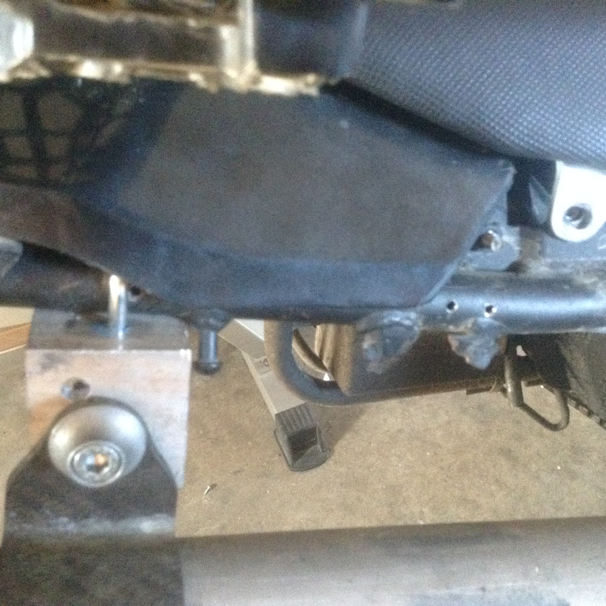

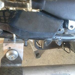

Default Ghetto repair
All the aftermarket silencer weight hung by the steel sub-frame tab which broke from fatigue. After several false starts I decided on using the aluminum angle collecting dust in my garage and a u-bolt bought for under $2. I expect the holes being drilled at the neutral axis of the sub-frame will minimally reduce vertical bending strength, but I have a plan to beef it up if needed. Cheap is beautiful. So is that Husky 701SM I want but can't afford for a few years.

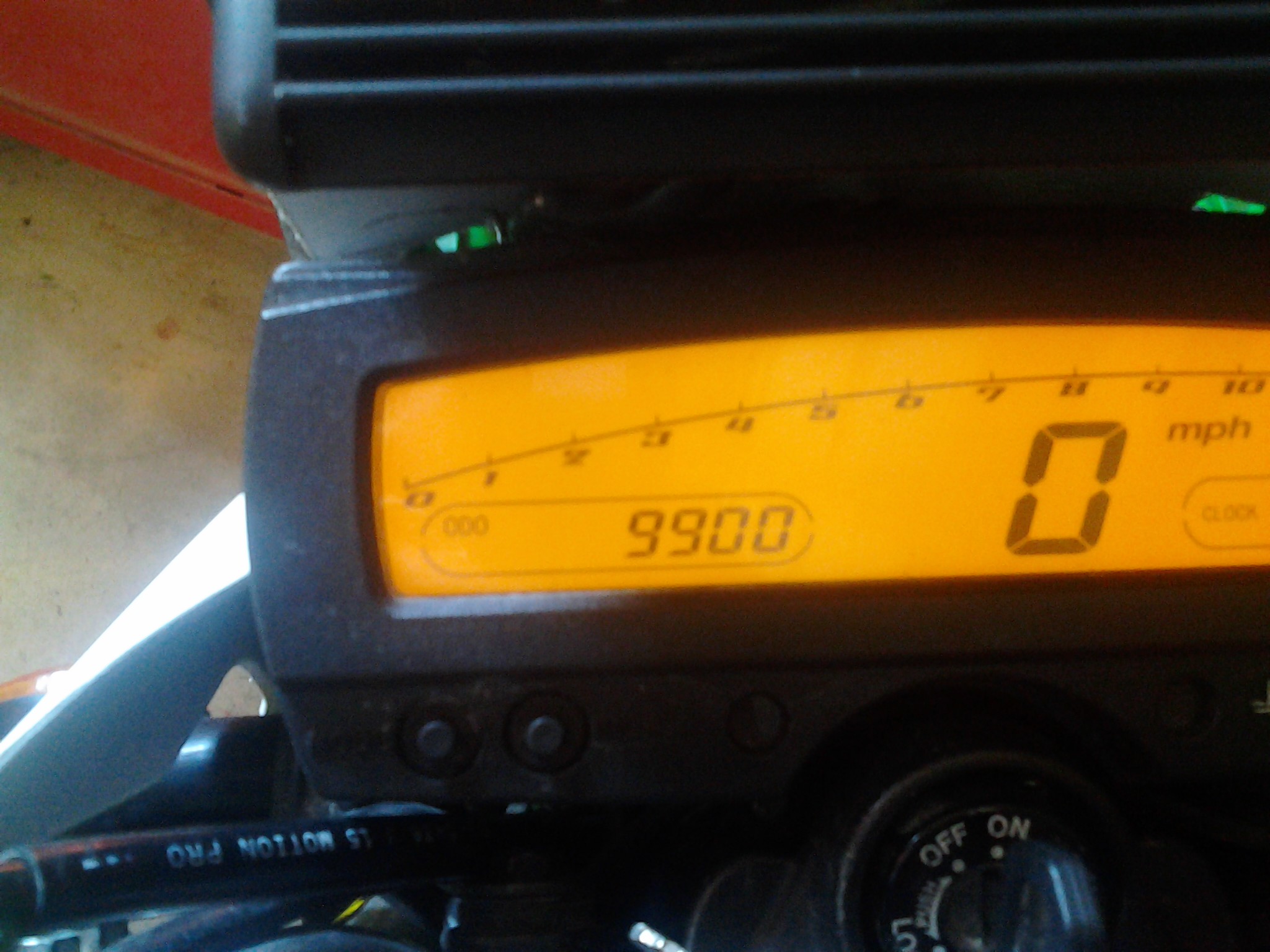

Gonna crack 10k this week

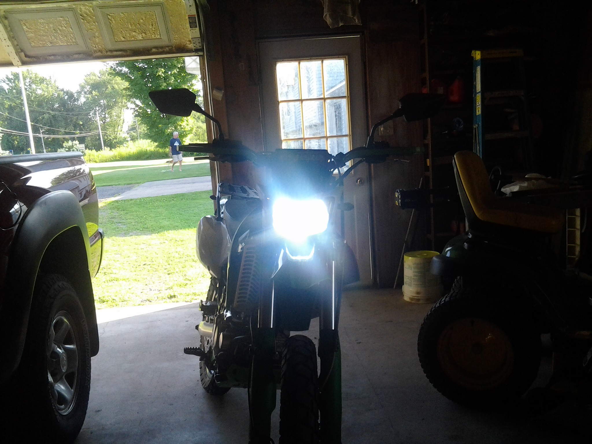

Out with the old in with the new 7.5 watts 450 lumen bulb. This should ease up the output with all the led bars going, gonna have to take a night ride now
