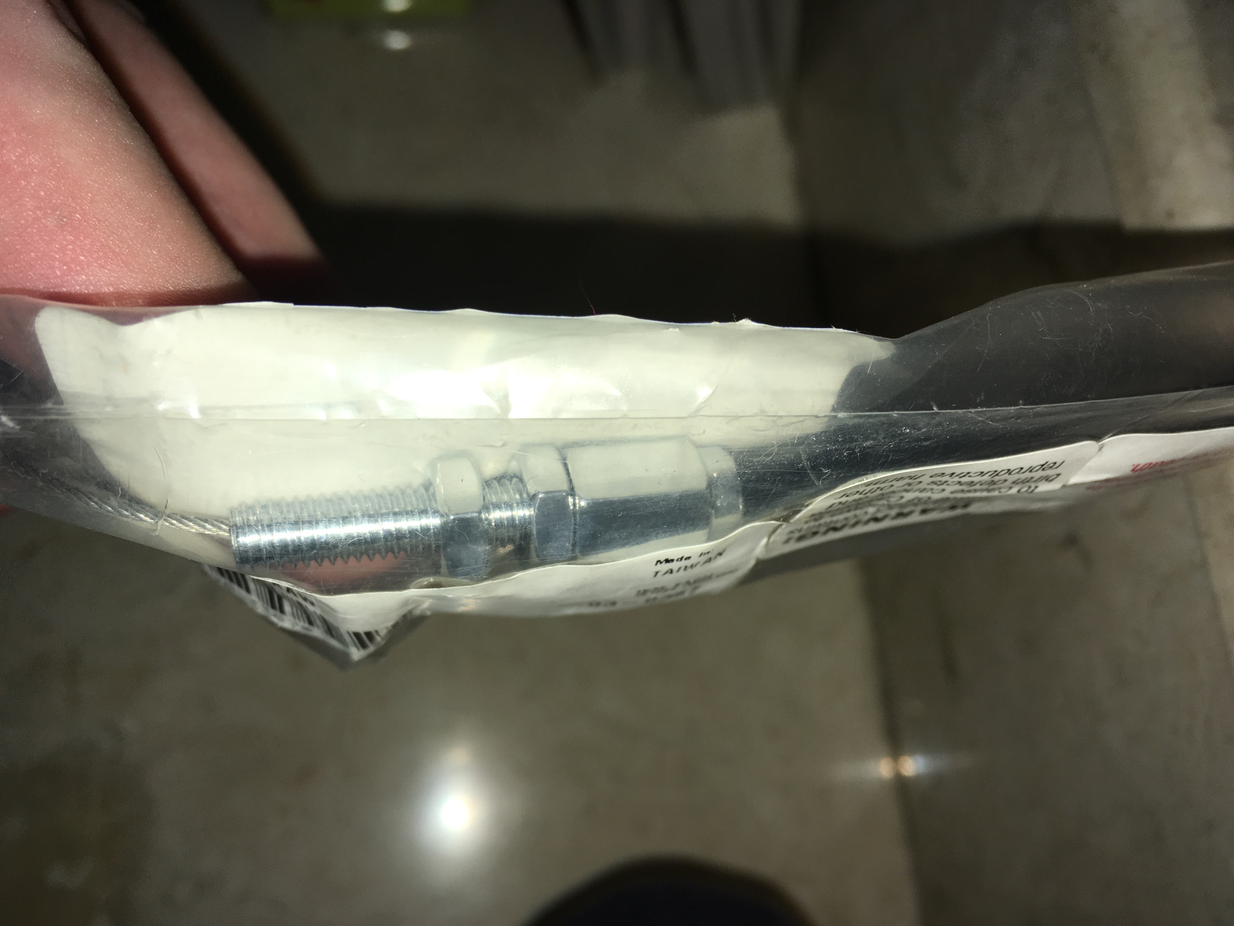

I finally got around to putting on the risers and getting the new cables on. I decided to make them myself with supplies from Venhill - it was WAY cheaper for me in the long run.
On a separate note, I found a local KLX guy who had a Motion Pro stock pull cable. Got it cheap. I wasn't planning to use it, just compare it to mine. He said he bought it and it didn't fit. I was originally planning to use it for parts if need be.
Comparing my cable and this one, they are nearly identical. About the same length overall. The only difference is the part that goes into the carb/FI. On the MP cable it has the two nuts and screw type ferrule at the end. Mine has a bent tube type ferrule. (See pics)
I'm thinking the MP cable could be made to work possibly. I didn't look in detail. But it might not "seal" properly like the stock ferrules do. I don't know if they are meant to seal, but the inside part where the cables come out into the FI on my bike is really clean. No dust/dirt to speak of. And that's saying something considering where I ride!
Anyway, it looks like there's a slight difference then. Unless MP has some slightly different variation that works? IDK
And I must say, making your own cables is fun! A solder pot, good solder, good flux and you're set!
