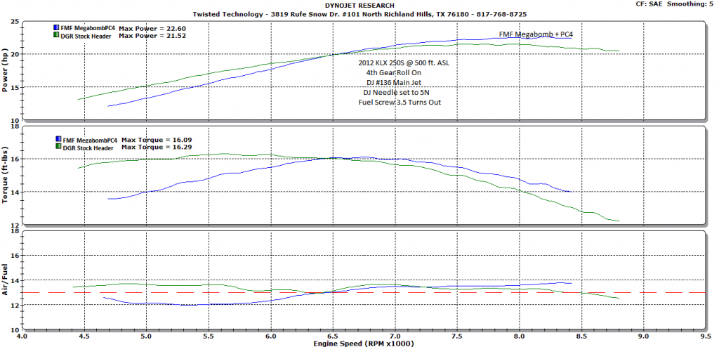

The data I've collected indicates that the choice of exhaust systems will radically change AFR requirements. Consider this chart, which uses the same carb setup with only a change in exhaust systems. The runs were taken only moments apart.. Be a deep thinker on this for a while and see what you come up with..
I'll help with a little detail: The DGR midpipe is same or very close to same size as the stock header. The FMF system is larger piping the whole way up to the muffler.
