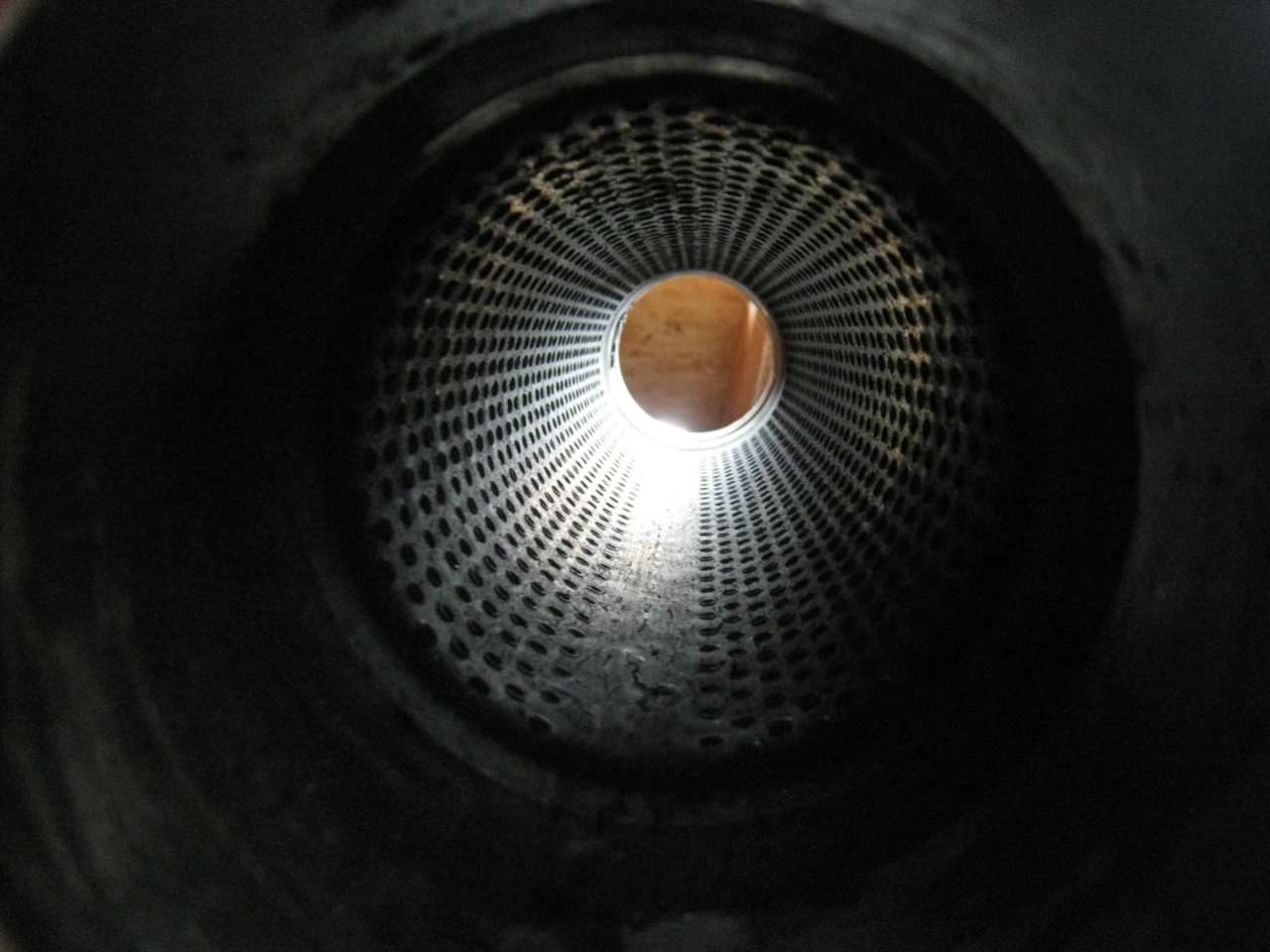

Virtually every aftermarket exhaust muffler design involves a single perforated tube wrapped with packing material, with the end cap being in line with the perforated tube.
Exhaust gases enter the silencer, travel along the perforated tube, then exit *directly* though the end cap. The only exhaust dampening occurs in the perforated tube itself, though sound waves are still able to pass through to the atmosphere.
This design is widespread since it is very cheap to make. Straight through mufflers are also measurably louder compared to OEM mufflers (especially like comes on DOT legal dual sports). Many aftermarket mufflers often have even shorter bodies than OEM. Many advertise these cheaply made (but expensive to us) mufflers with names like "Big Gun" in order to make the noise seem sexy and desirable.

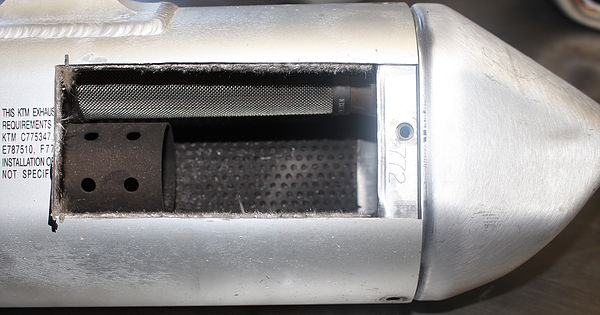

2016 KTM/Husky Exhaust
We've graduated beyond simple straight through design above. We're discussing ways to incorporate a design similar to what KTM and Husqvarna use on the 2016 EXC/FE models.
These lightweight silencers have a longer body sectioned off on the inside. The first 12" is straight through with fiberglass packing. From there the exhaust empties into a resonance chamber which itself is lined with a thinner rock wool layer, then exits via offset end cap opening. The gases (and sound waves) do not have a straight shot out the back of the silencer like with every aftermarket muffler sold.

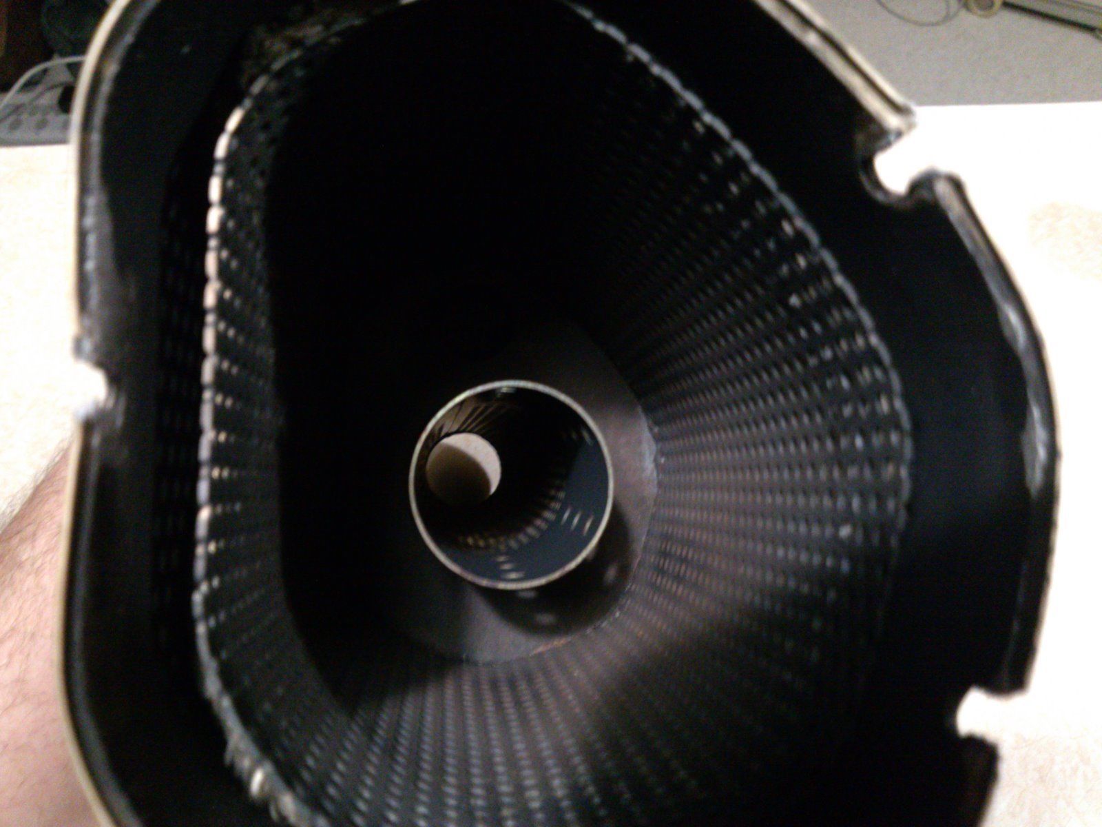

Looking in from the back:
The body itself is larger in diameter, too. Some models also have a small perforated disk at the end cap, further reducing dB's while keeping desirable back pressure.
Decibel levels are DOT legal (around 80 to 82) with this new KTM/Husky muffler design. Obviously power is not affected - KTM is easily the fastest bike in class. These 2016 style mufflers are light weight and look good.
