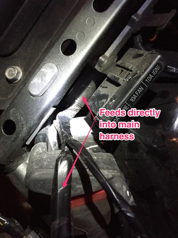

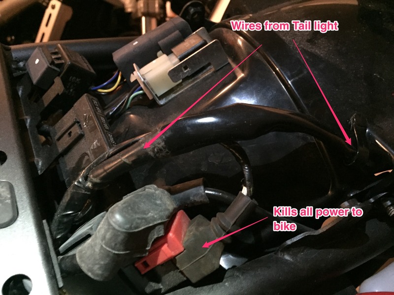

So on to my question..... I've followed the wires from the rear brake light to fine where there might be a plug before it hits the main harness and I can't find one. The wires go right into the harness.
Am I missing something or do these wires just go directly into the harness and my only option would be to test out then splice this device in?

There is a plug at the light end?

The plug (as long as the taillight is stock) is under the tail piece farther back.

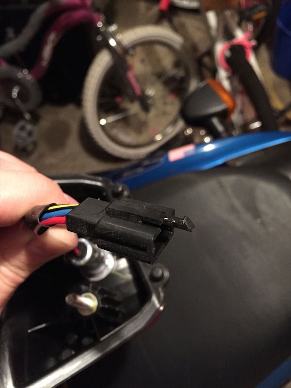

The tail unbolts from the underside IIRC.

Just splice it under the fender, it is only 1 foot away.

The bolts undo the tail piece which will reveal the wiring plug.

Yep...you guys were right. Unbolted the light housing and the plug is only about 5" from the light itself. Thanks for the guidance. It looks like splicing the unit under the seat will work best.
