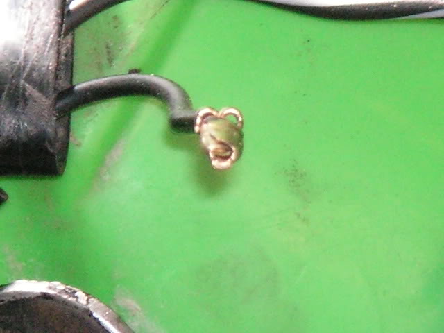

Here ya go.
This is a large male connector squeezed up to fit in the small female connector.
mmmm large male in small female

That's what I was doing earlier with some crimpers but I stopped because I thought I might ruin the connector. Thanks!
