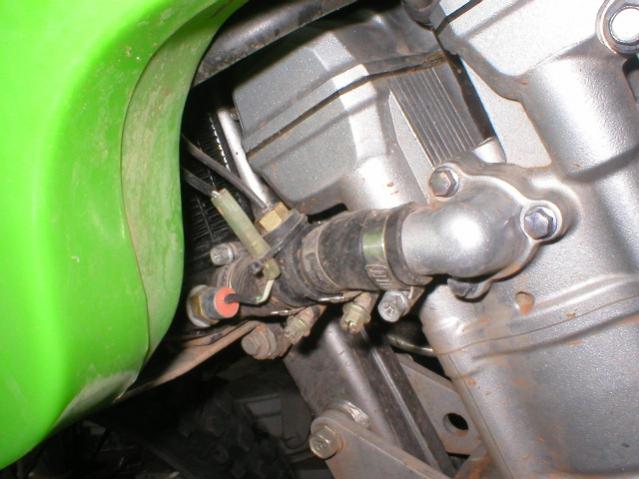

Here's how the water temp sensor fits in the line on the driveside of the engine. IMO this is one of the most valuable elements of the Vapor and other Trailtech models that have a temp guage. This thing really lets you see how your engine is running under stressful conditions.
