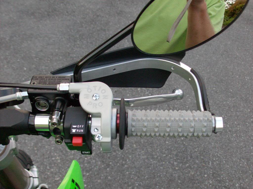

I have the Vortex and it is taken me sometime to get use to it on the pavement, never tried it off road yet? I could only think the tight trails would be tricky, a pumper carb makes it even more touchy.
But if you are on the road it works great once banging threw the gears!
