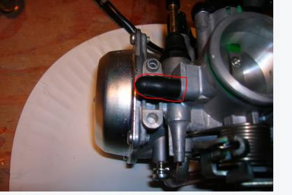

just curious, what does the vacuum line going into the carb actually do? i mean its there for a reason right?
Attached is what ive seen from a few other threads. Since im running just a pod filter it would be WAYYYY easier for me to plug this fitting like the images and remove all the smog stuff. just didnt know if it would mess anything up.
Thanks again!!!

Of course it has a function - it operates the fresh air valve for the exhaust port when necessary.
You will do fine with it plugged.
I guarantee you that you will be doing some serious jet work with the pod. I don't know who has trodden that territory before, you may want to search or post the question to see if anyone has.

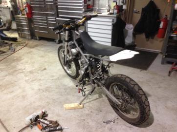

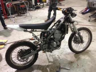

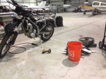

I kind of regret it, but i did about zero research on everything before i started chopping up my bike. I just knew what i wanted in my head so i started doing it/ordering parts at the same time.
it all started from some bent handlebars. I needed to replace them and then i started tearing off all the body panels, exhaust, airbox, gas tank. decided i am going to do the pod, if it works, do an under-tail muffler, chopped the rear frame right after the seat mounts, redoing all the turn signals, brake and rear running light, relocated the coolant res and battery, going to lace up a matching 18 inch rim for the front. basically turning it into a custom looking supermoto style KLX, prob 80% street 20% offroad.
I ended up doing a jet kit on the carb two nights ago. I ordered it from 6 sigma, where you tell them what you did to your bike and they send you a custom jet kit. Im really really banking on them sending me the right kit and parts so i dont have to pull the carb again and readjust. (wishful thinking probably)
I followed their suggestions that came with it...Put two shims on the needle jet, put a 127.5k main jet in (came with three main jets, a step above and below the 127.5, instructions suggested using the 127.5) #38 pilot jet, backed the mixture screw out three full turns.
thinking about putting up a gallery and write up of what im doing. from the little research ive done and comments from buddies, i dont think to many people are doing what im doing right now with their KLX250s.
again, really appreciate the info guys, first time doing something like this so all the help is very useful!
first two pics are with no handlebars, frame is stock, second two pics are with new bars, frame is chopped after seat mounts and rejetted carb with pod filter installed.
