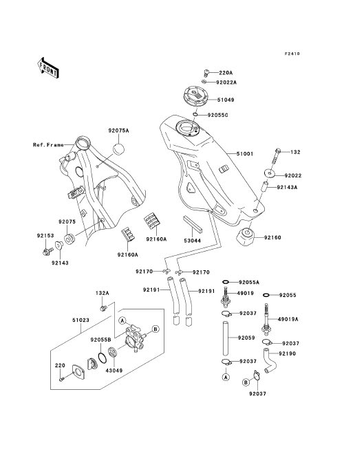

""The KLX250S petcock doesn't insert into the tank. It's totally external and hooks to two separate hoses which connect to two separate brass fittings on the bottom of the tank. Of these two brass fittings, one fitting's pickup is longer (main) and it is mounted forward of the reserve fitting. ""
Ahhhh , good call, now that you mention it I know the valve is mounted to the frame. I never paid any attention to the outlets on the tank on the new bike. Do the brass fittings unscrew, and come out of the tank?
I'm just wondering if he still had one come apart in the tank?
Possibly... I'm just trying to go simple first since drawings can be pretty unclear at times.

Here is a drawing, I don't know if it will help.
