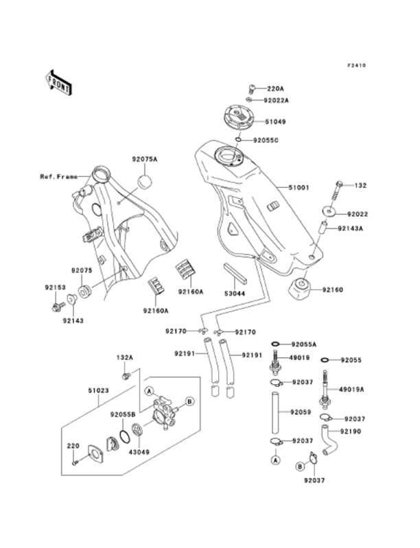

Does the tank have enough gas in it for the primary pickup? If it does, you may need to pull the gas valve and give it a good cleaning. Here is a diagram.
Looks like A & B are the "on" and "reserve" outputs. I have to say that ours looks nothing like the old bike pickups. So this is where my understanding ends on how to clean it. Good luck.

Oh wait I see it now. 49019 and 49019A are on and reserve. So perhaps 49019A is plugged since it's the tallest pickup and would be the one for the main gas.
