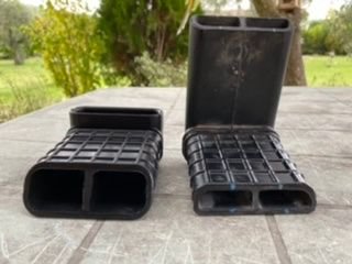

Standard KLX250 EFI airbox inlet pipe on the right. Cross sectional area is around 720mm2 (1.12inch2). The new replacement inlet pipe (on the left) is from a KDX200/KL650a (part number 14073-1577) and has a cross sectional area of around 1550mm2 (2.4inch2).
The cross sectional area of the 34mm intake of the EFI model is 908mm2. The standard inlet pipe/snorkel cross sectional is significantly smaller.
Inlet pipe mounted in the airbox lid.
Step 2: The airbox lid fitted into the bike. Air flow capacity is now more than double but noise levels are barely increased: essential for keeping environmentalists complaints to a minimum and keeping country lanes open to motorcycles. And for having fun!
