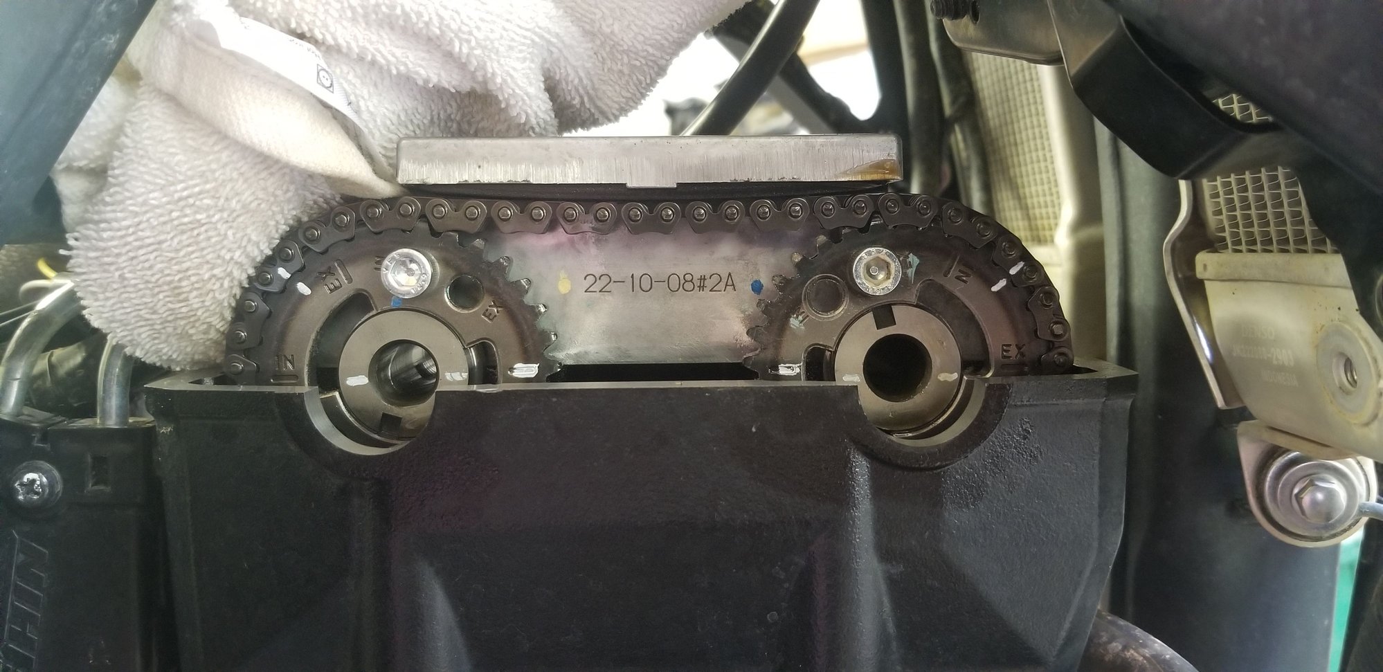

Quick sanity check please. Does this look correct?
Stock
Intake
MCM Complete

Looks good. Just need to had crank it a few rotations manually, crank it a few times with the key, put in the spark plug, start it up and enjoy. I noticed a big difference in the note. Sounds better than my friends WR450.

Just got it put together. Tested as instructed then fired it up. It runs. Raining here so can’t give it a test run. I’ll give my thoughts when I put some miles on it.
Thanks for the help.

So how did you find the process doing the mod without taking the cams out?

It was a little cumbersome but not too bad. I was able to get the sprocket back on the cam by hand and didn't have to use a screwdriver. As you stated it was a bit of a chore getting the sprocket off the chain.
I think if I did it again or changed it back I would do it the same way.
