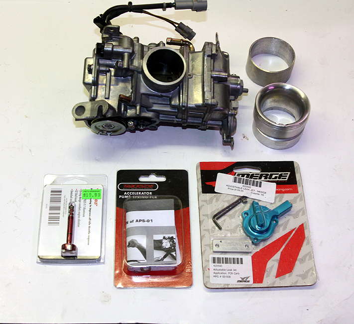

I want to see if you can use the mrege racing adjustable leak jet and the scarry fast power now on the fcr35 if so I might go that way,i will have to keep a eye out on ebay for one.

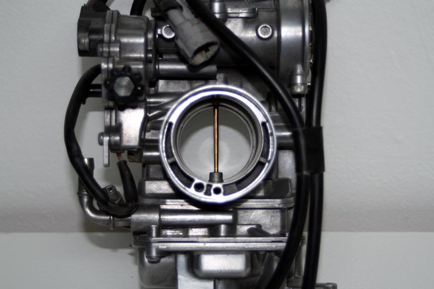

It is a drag that the fcrmx wont fit on my klx250sf
but I am over it now, my wife says that I would be Pussin out if I just blot on a mikuni ready made flat slide so now to find a fcr 33 or 35 and go from there
this carb now will get set up for a drz 400 or a dr650
Life goes on

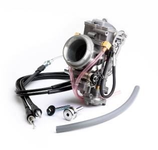

This is what I need fcr 33 35 I would rather have the 33 over the 35
I am sure one of you dudes out there has one sitter around ya want to get rid of
Bill 113moto
