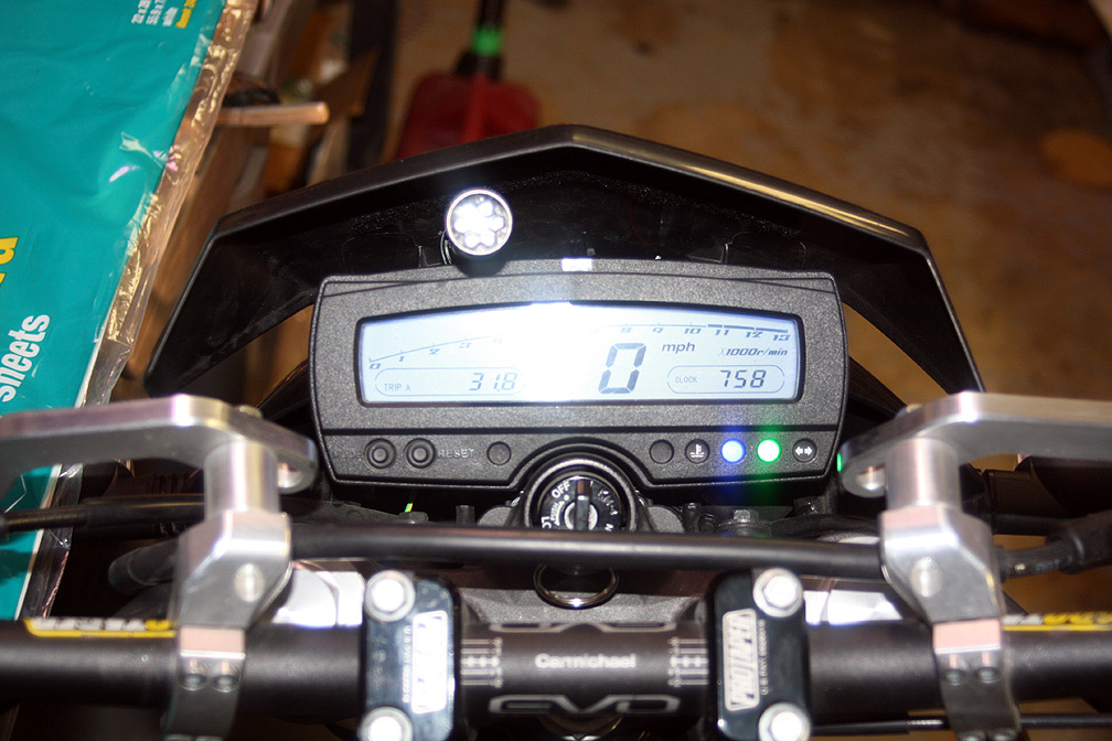

Originally Posted by Richard Avatar
What brand is that shift light on the bike in your website video? Can I add that to my KLX?
Richard for sure on the klx it is a great tool you can get them from
speed hut easy hook up hot 12v wire ground wire and one wire to the coil
here is the one on the klx
Bill.
http://www.speedhut.com/ecommerce/pr...ift-Technology)
Bill.
Which side of the coil would it hook up to ? Interesting but a bit expensive
it goes on the black and white wire

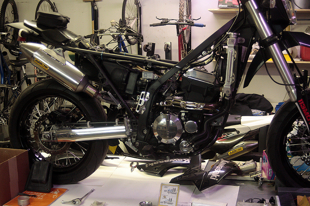

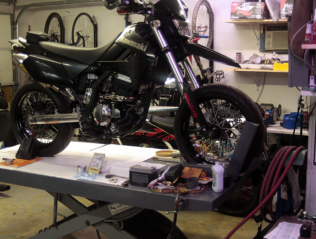

getting started
while waiting on parts I will do a little poking around may be do a valve check

Time to do the cam mod then
I think this is all I'am going to do for right now
the Bike is rock solid and is a great ride
This is my wifes bike and she does not
like for me to get too crazy with her stuff.
Old Nov 6, 2014 | 09:44 PM
  #28
Richard Avatar's Avatar
Joined: Mar 2013
Posts: 866
From: SE Asia
The cam mod is free if you haven't read up on it. Adds a few HP after easily advancing the intake cam and retarding the exhaust cam by moving the cam sprockets around.
