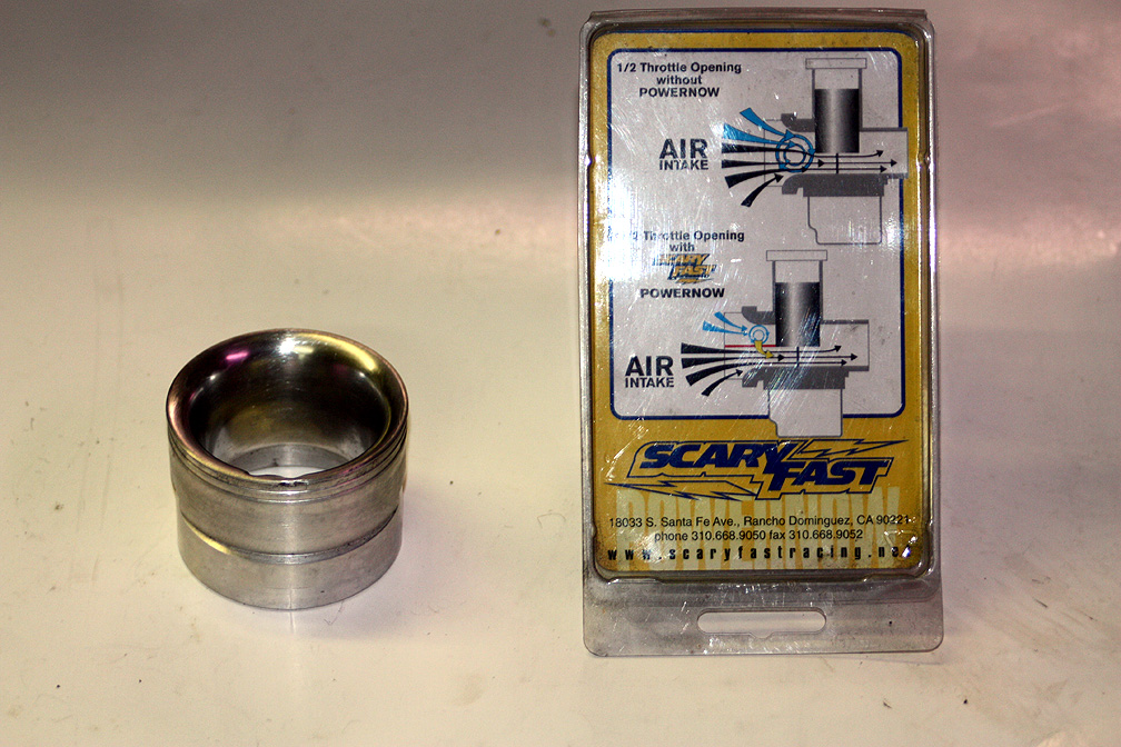

I found a nice fcr mx 37 on ebay it is on it's way
the fcr can be heavy on the time to get it right but that is what I do for a living.
I have installed many on other bikes and I know what it is all about
but I really like those carbs you can do a lot with them.
Here is some left over parts I had around the shop that I will use on
the klx fcr should be fun a nice adapter to go to the air box
and a scary fast power now

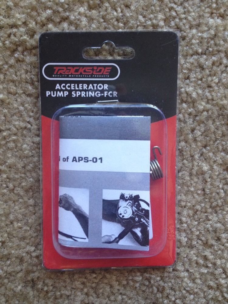

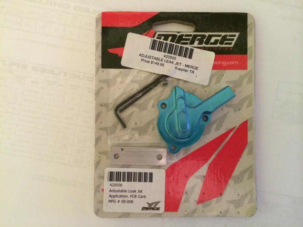

klx678 I am in south Dayton
as far as the round slide as long as you can make it fit and jet it right you can use
any carb you want here are some other tools I will use on the klx fcr if you want to see
more of what I do I have a little home made web site you can check out I am still working on it
www.113moto.com
