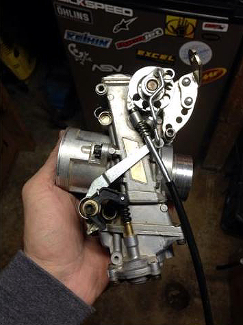

The fcr35 came in yesterday
I had to do some mods but it fits
The carb is in great shape like new
works great
now for the tuning even with it not perfectly in tune
it has a big hit
should be a great up grade when it gets dialed in

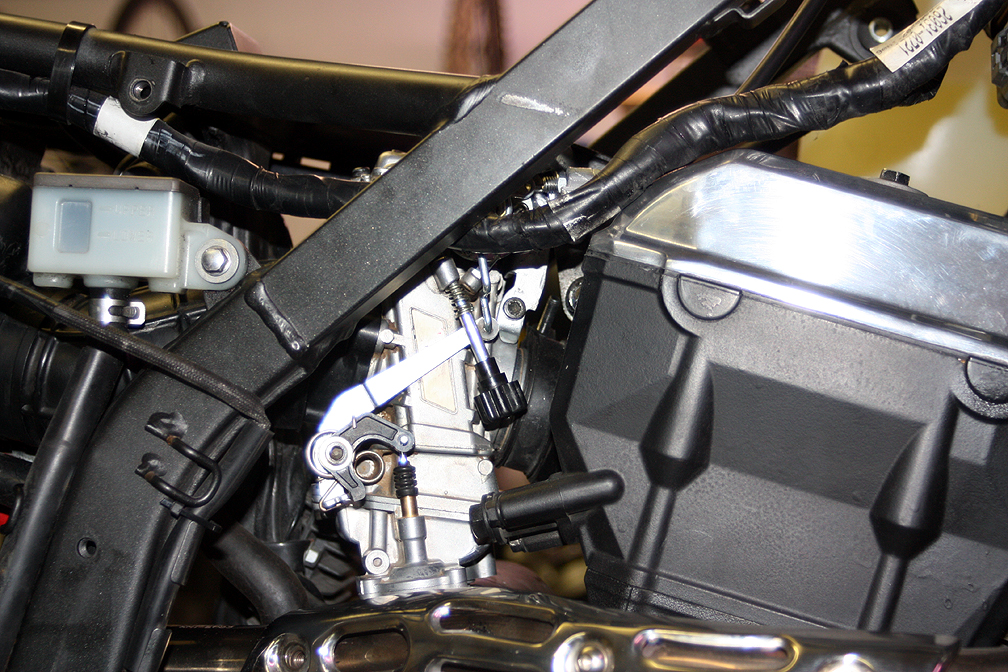

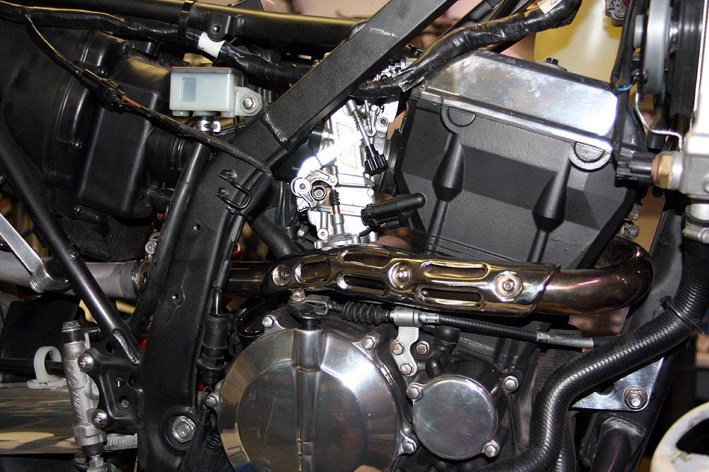

2009 klx250sf with fcr35 pumper

I wonder if it will fit with a KCCT mounted? Looks mighty tight in there.

Lookin' good! Is the AP clearing the header okay, or did you have to dimple the header?
What model/year bike is that off of in case others want to copy your mod?
I did one of my CCTs with a slotted end on the bolt and a short bolt to fit and clear the pump on another rider's bike... where there's a need there is a way. It ended up just about the same length as the stock one. A bit harder to adjust, but works.
Here's a thread on an FCR35 install for comparision..
The ap clearing is fine
It is not off any Bike it is a Sudco carb removable air boot and intake mounts
