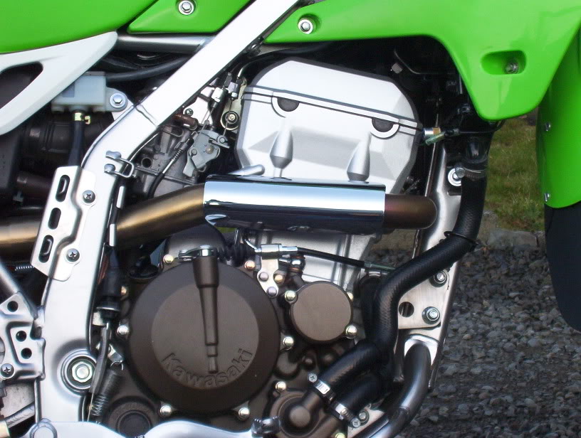

Old May 9, 2007 | 05:35 PM
Default RE: Heat Shield Mod
I still like mine, and it looks new still.
