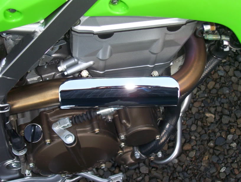

Default RE: Heat Shield Ideas
Yea I was going to see if the shop could do the weld for the stock heat shield, but I saw the chrome one in the shop and decided to try it, and it was only $18.00 so no biggie if I decide to change it out. Here is the picture of the one I bought in case we decide to keep this open for heat shield discussions. Later all.
