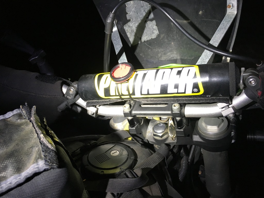

OK, technology is with me today...upload complete.
Hope the picture helps a little.
This is how I've had it set up for years, even before the bar risers.
Mount them tight but not so tight that they can't move from a serious hit.
I've crashed so many times and have only needed to loosen and realign them.
Worth there weight in gold.
