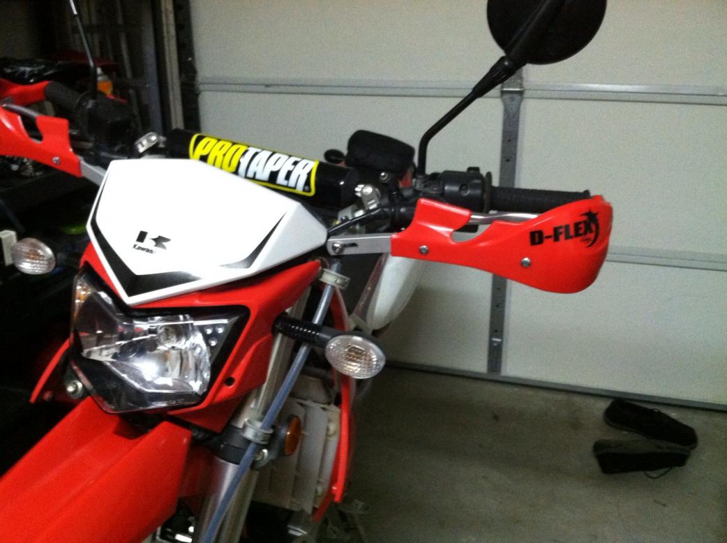

I like my tusk guards. Pretty reasonable from Rocky Mountain Atv.
