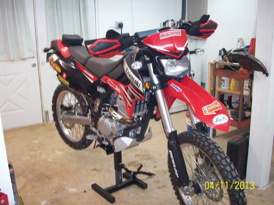

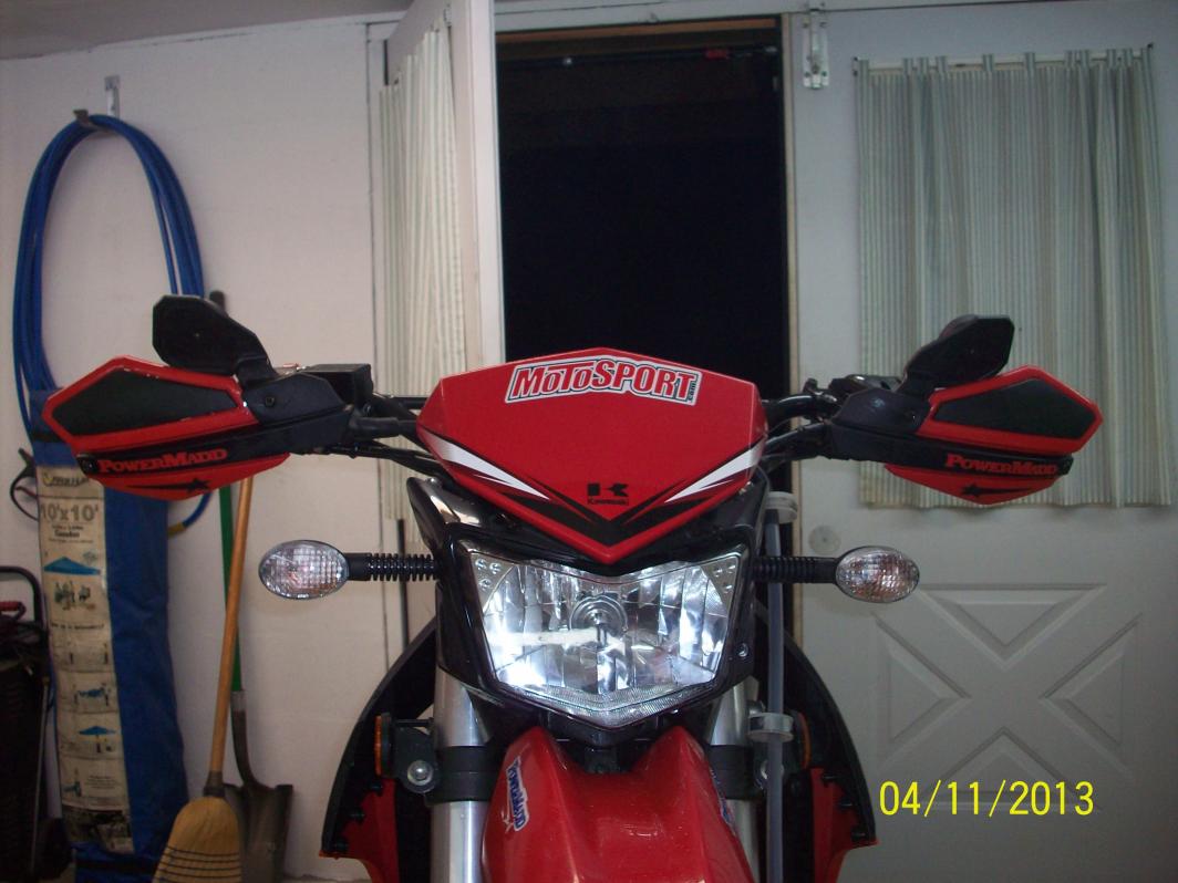

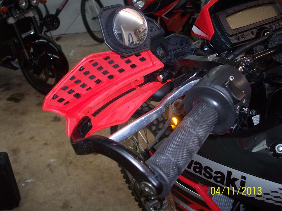

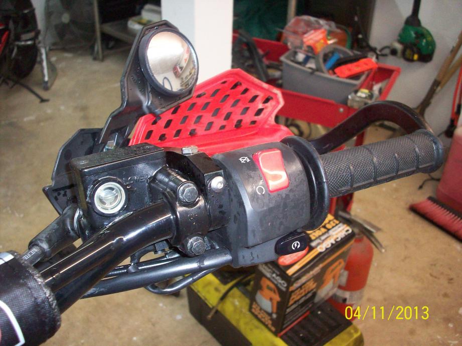

Just wanted to post up some pics of the Powermadd handguards I installed. I modded the mirror position to get a bit more crash protection-they are acceptable(decent even compared to some of the sportbikes I've been on). I ground down some of the R/H oe mirror mount to make it fit properly. They have been crash tested with very good results...

Those HBD units look like they have more room for the levers, I like them. I'm getting them next time. Where you get them?
The post with the red bike, it looks like you installed them with the bend up. Most have it down, that may work better, post a report after you crash please (hope it is next year at least).
