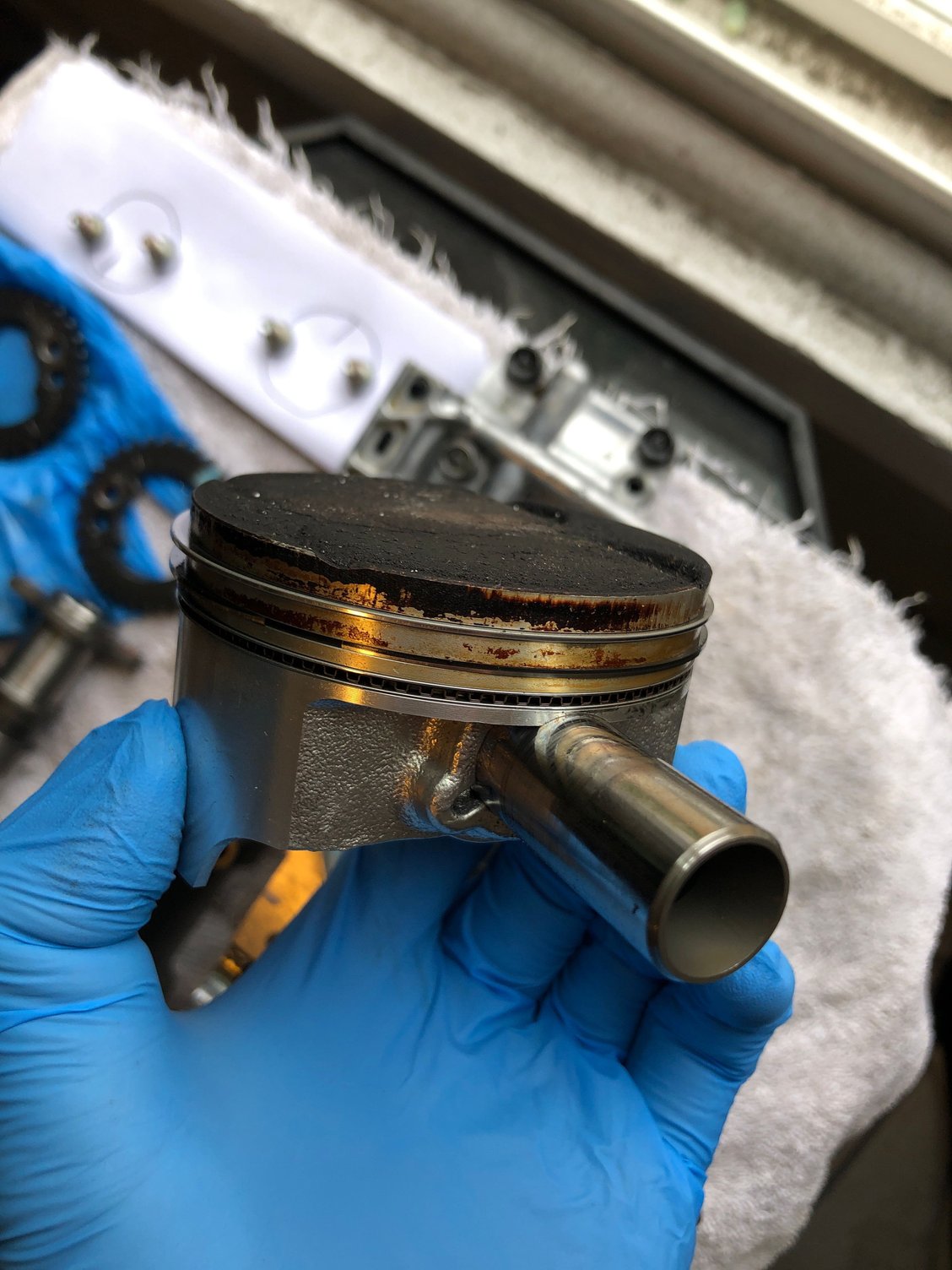

can only see the top of the piston. can you take some side shots.
(oh yea, we forgot to mention that circlip could hit the ol eyeball too! lol)

Ok now that this beef is squashed... can we get back to this engine 🙃
judging by the condition of the piston, is there anything other components I should be inspecting? Cams, gears, etc.

My thoughts are that piston has a lot of carbon, either run too rich too long or the other possibility is run too much at low rpm. Some riders try to chug around thinking the higher rpm hurts the engine, running out of the efficient range of performance builds up carbon too. Lugging around trying to ride the bike like it's a tractor. Happens all the time with cars and such.
Gotcha. The cylinder is now en route to billy blue so that's piston plus cylinder are being replaced.
Is is there anything worth inspecting down low tho? Crankshaft, gears, etc?
Ill attach photos of the cams later me later on to get everyone's opinion.
Thanks!

Based on my research, nothing is damaged. Everything looks like normal wear.
Would y'all agree?

Your cams and journals look great! I wish mine would have looked that good when I took mine apart. Does look like some carbon build up on the side wall above the top ring, no big deal. The skirts look very nice though. (I am a big fan of nice looking skirts) Check to see if you have any radial play in your lower rod bearing and slide the piston pin in the upper rod hole and see if its tight-ish. The main crank bearings swim in oil and rarely are bad. Its the two rod bearings that go first. But from looking at your pictures, that's a happy engine!!
